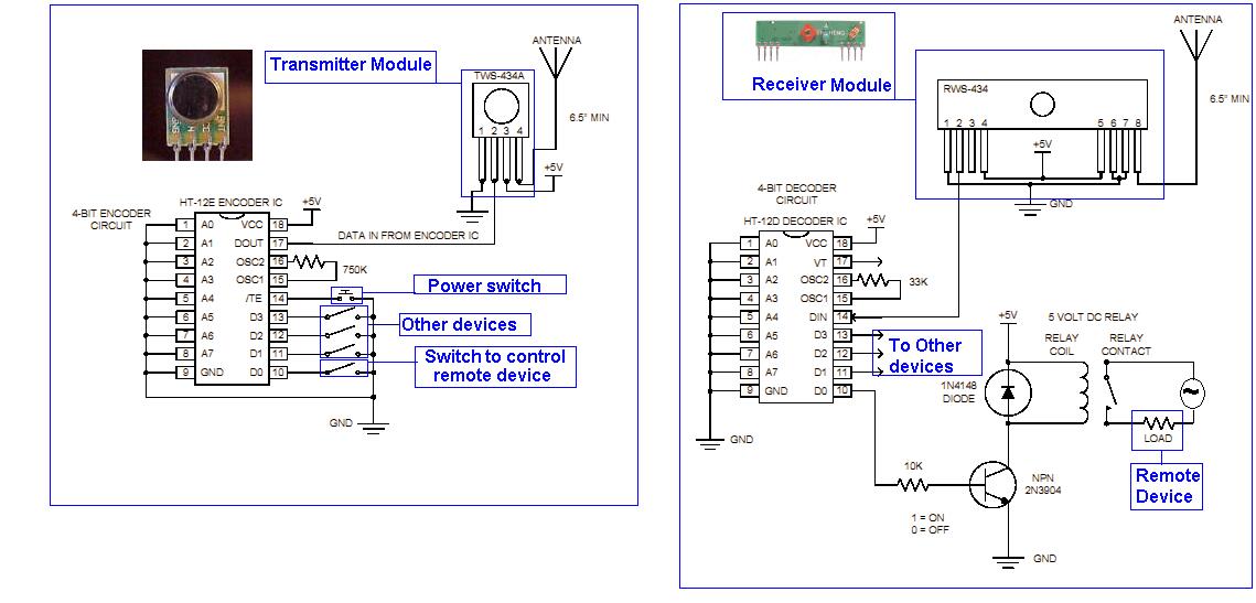

Maybe this sketch is clearer with all the parts right side up and without Chinese writing:
i should be gettin those HT12Es in the mail tomorrow. I ordered 2 samples from holmate, holtek's North American representative.
Where did you get that schematic by the way audio?
