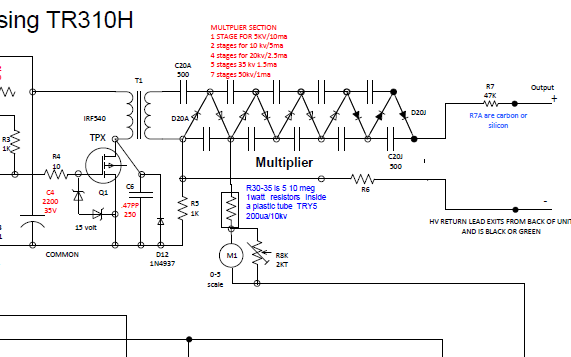

a "static field" isn't high voltage AC, but high voltage DC. if you want high voltage AC, you can use the function generator to drive a flyback converter (a transistor driving the primary side of a transformer that has a high voltage secondary). there's a suitable transformer here: https://www.amazon.com/15KV-High-Voltage-Transformer-Coil/dp/B06X1BHYQ6#feature-bullets-btf
if you want high voltage DC, simply add a high voltage rectifier and high voltage capacitor to the output side.

Yes, you are right. I would just use the protected power transistor shwon in the diagram, without the multiplier, for AC out. As stated in my OP, waveform is not critical.

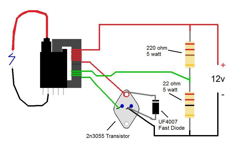

I have built simple HV circuits using TV flybacks (see diagram), but never pushed them above their specified frequency of around 15KHz. Might be worth revisiting. However, for efficiency, I was hoping for something closer to my previously stated frequency range. What we are doing is placing piezo-electric transducers in an electrostatic field, and tuning the latter in frequency to induce resonance.

the molded type of flyback has a DC output, because it has diodes built-in. i think there's also some capacitors in there too, although with the dag on the CRT there's not much of a need for the caps to be inside the FBT. you really need the "old school" type of flyback for generating an AC field. that's why i described how they are built, because it's not easy to find that type anymore.
