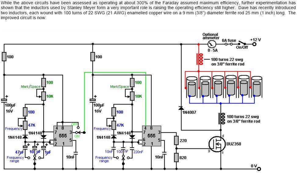

I myself post on https://www.overunity.com. I have attached a circuit diagram of an improved version of the circuit supposedly designed by Stanley Meyer. It pulses the the power input at different rates using a 555 timer IC. Different settings like Frequency and Mark/Space are changable by 10K Pots. I'm not sure of the portion of the circuit on the left of the circuit. It is another part of the settings, I guess. But see what you think and try it.
It does no better than DC.
skeeterb said:
I myself post on https://www.overunity.com. I'm not sure of the portion of the circuit on the left of the circuit. It is another part of the settings, I guess. But see what you think and try it.
The "right" side provides the basic pulse frequency. The "left side" turns that pulse train on and off (i.e., modulates it). Is that what you are not sure of, or was it something else? John

Thanks for the circuit Skeeterb
I printed that circuit. Now I need a parts list, and some dummy explanations!!! Old guys can learn new tricks.
