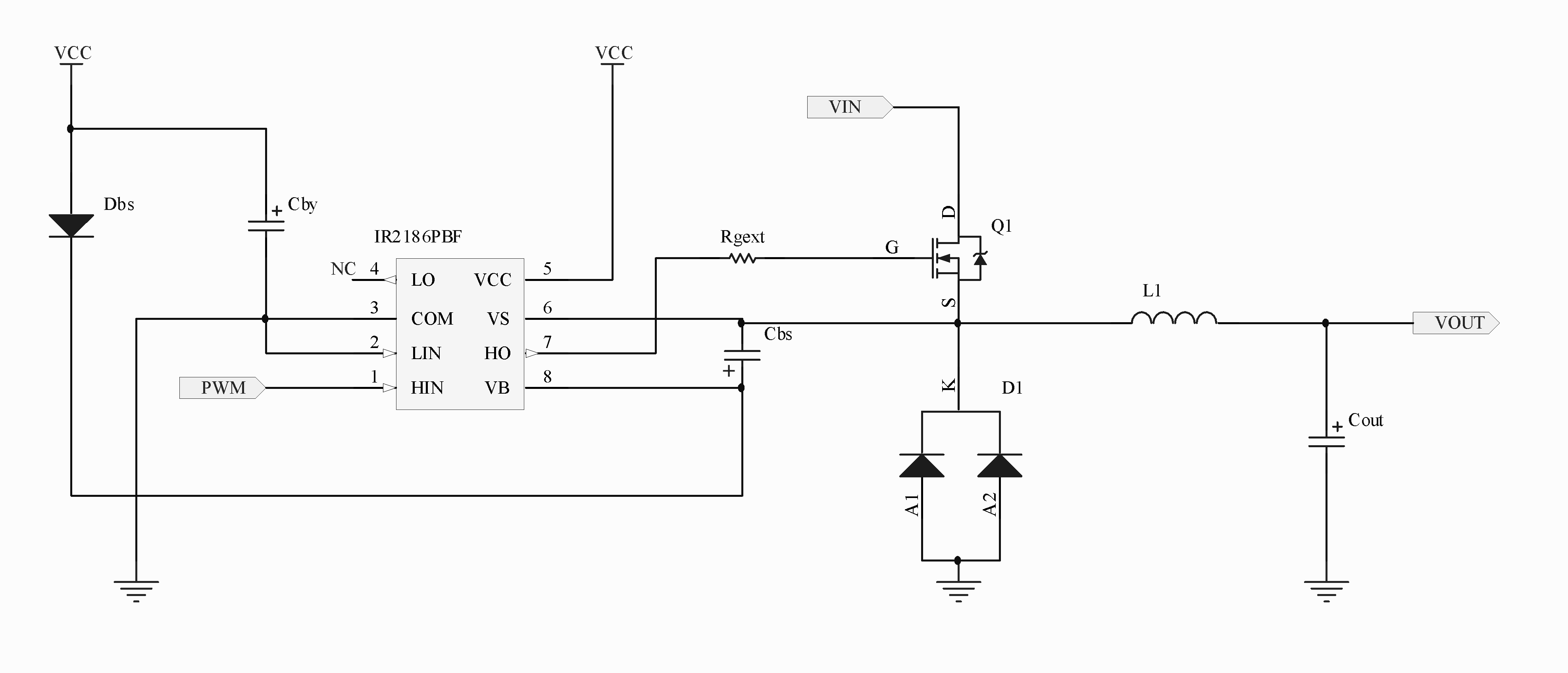

- I am making a buck converter to go from 12 V to 4 V (more or less). The circuit is attached (Esquema 9_sinborde.png).
- Currently there are no control closed-loop. I'm regulating manually the frequency and duty cycle of the control signal (PWM) with a Function Generator. I use a 100 KHz signal with aprox 20% Duty Cycle.
- To control the NMOSFET I use the IR2186PBF driver with a bootstrap capacitor.
- At the moment the load is a resistance of 1 ohm (high power)
- Attached is a chart (Esquema18.png). In blue is the signal on the gate of the NMOSFET (coming from the driver). In red is the voltage Vs.
- As you can see, I can not increase the control voltage of the MOSFET above 12 V. This makes the MOSFET to no turning on properly, and as a result Vs becomes no very high.
- The supply voltage of the driver is 12 V. I am interested in powering the whole circuit at 12 V.
How I can get higher voltages to activate the MOSFET's gate abundantly (of the order of 20 V)?
The component values are the following:
Driver = IRS2186PBF
NXP MOSFET = PSMN1R8-30PL
D1 = STMicroelectronics STPS60L30CW
L1 = Abracon Corporation AIRD-03-8R2K 8.2 uH
Rgext = 200 Ohm potentiometer, regulated for the best results (few ohms)
Cbs = 47 uF 25 V
CBY = 2.2 uF 63 V
Dbs = FS 1N4934
VCC = Vin = 12 V

If you want to achieve 20v this will have to be at least 2200uf @ 50v. You need to dump the coil breakdown voltage into the cap. Why is there two schottky diodes in parallel ? These should be after the coil.

I have two schottky diodes in parallel because it is incapsulated in the same package TO-247 (STMicroelectronics STPS60L30CW). Must I use only one leg of the diode package and let the other one not connected?
What you mean in saying "These shoud be after the coil"? You mean that the Cout is after the coil, of course?

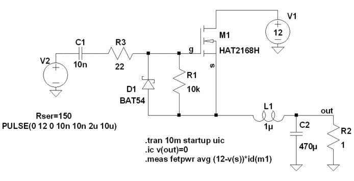

To raise the gate voltage you could apply the drive pulses via a capacitor (C1 in the attached).

You're missing the diode in the buck converter part and AC-coupling the drive signal to the gate will not give the required swing to both turn the mosfet fully on or off.
The original schematic drawn by Quank looks like the one in the datasheet, and should be suitable; that is if the component values are appropriate. The gate voltage is ~12V higher that the source voltage, so the chip is not doing anything wrong in that regard. It is acting as though the mosfet source is connected to ground though. Is the inductor of a suitable value? Can you post the part values?
I simulated the above circuit both with and without the diode you refer to and found (surprisingly) it made no significant difference. Simulation shows the FET switches both fully on and fully off. D1 prevents the gate going negative of the source and bootstraps the gate voltage (for the components shown the gate voltage rises to ~16V). R3 is the typical oscillation-damping resistor, but in addition I assumed for simulation purposes that the gate drive voltage-source had an impedance of 150 Ohm.
That should be ringing some alarm bells then; it's because the mosfet is always on and the inductor current just passes through the mosfet the whole time.
No it doesn't. What's the voltage on the FET gate? If it's not above 12V, the FET is is not fully on.
Really? I don't believe that.

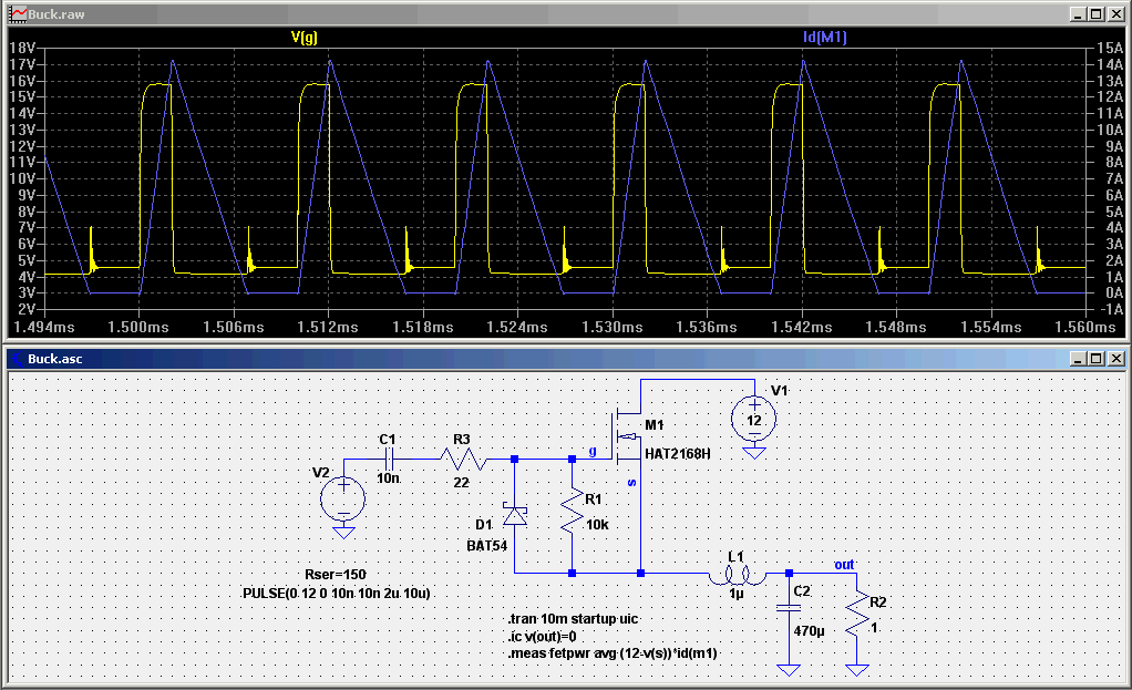

Perhaps this will convince you :). I've included the asc file if you want to run the sim.
Ok, you're quite right re the gate voltage reaching 16V; I've been converted, I'm a believer!
It doesn't change the fact that the circuit doesn't turn the mosfet fully off while the inductor current is flowing. It's not a good converter.
Quank, Your circuit should work: however the bootstrap capacitor is much to large at 47Ufd. Usually 10X the FET gate capacitance is a good rule of thumb. You might want to check the bootstrap diode to make sure it didn't pop the first time 12 volts was applied. I didn't see trace names on the scope picture, but gate and source would be nice.
