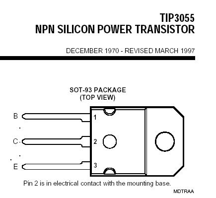

Hi there is an alternative package its TIP 3055. But there’s a difference in the output wattage between this SOT 93 package & the good metal package.

Which has the higher wattage?
Please I want to know which one on them has the higer wattage. Secondly, is there any other distinctions between them. Thanks
The TO3 one has, fairly obviously! - it's a MUCH more substantial encapsulation.
It's perfectly possible to solder to the case of a TO3, and I've seen it done commercially - but it's really a pretty pointless occupation, and it's not the way it's designed to be used. Bolt it on a heatsink, with the correct mounting kit, and use a solder tag under one of the bolts - as it's supposed to be used.
Most TO-3's are sold with mounting bolts, nuts, washer(s), and a terminal lug that fits under one of the bolts. If the one you bought doesn't have the mounting kit you can buy them seperately.
