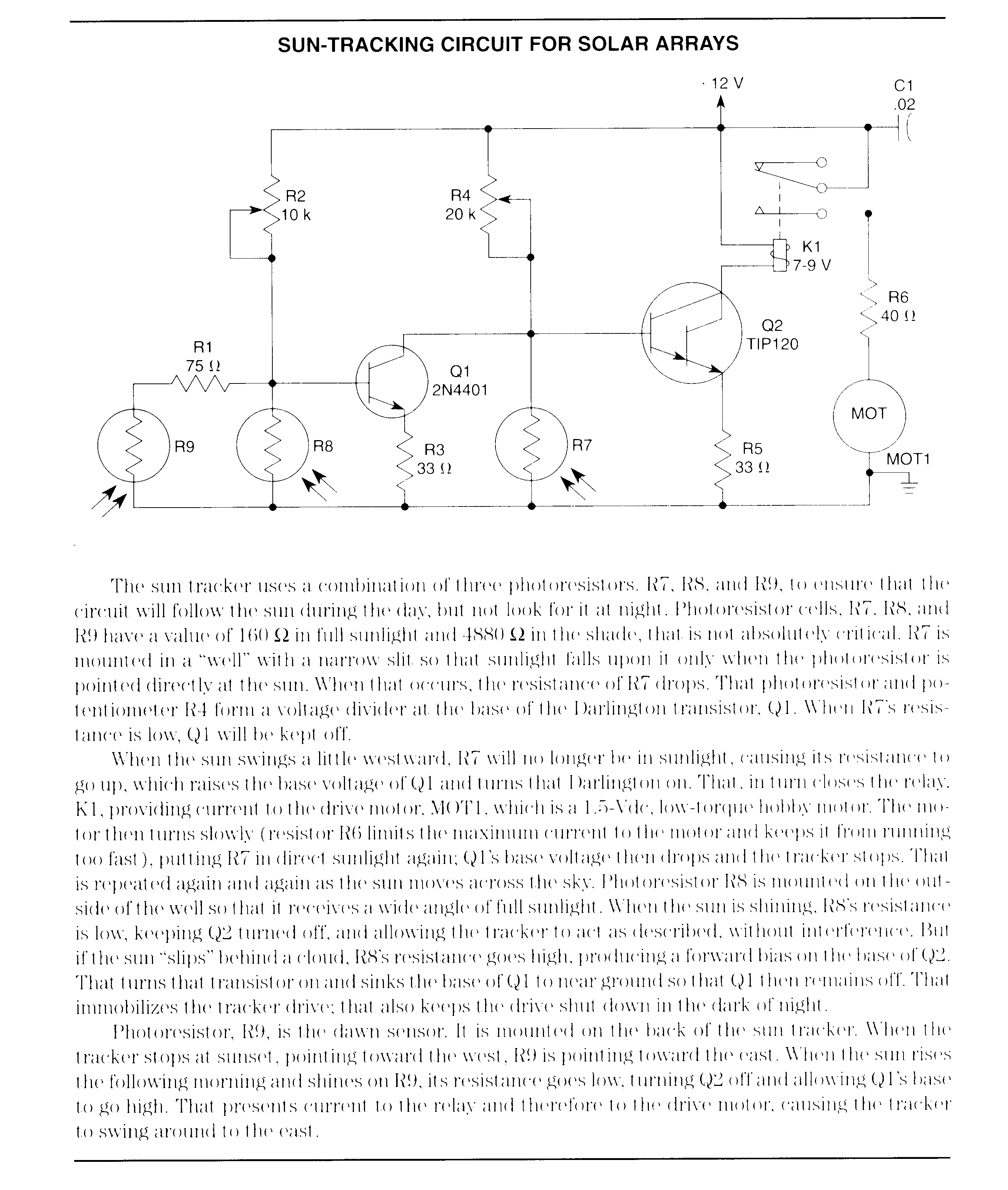

Here's a suggestion...
You don't have to use any programming at all. This kind of circuit can be built using a few ICs. Perhaps you've built or heard of robots that seek light. They use 2 photoresistors (or phototransistors) and a comparator chip. When left sensor "sees" more light, right motor is enabled and rotates the robot until both sensors see equal amount of light. You can apply the same principle to your sun tracking solar panel. Try searching for "light seeking robots" (or similar phrase) to find a circuit. The only problem you might face is that these robots usually move straight forward all the time, but I think that you could correct this behaviour by using a few logic chips...
This might help, the site "cicuitos.terra.cl" appears to have closed down this gif image is from my picture grabbers monthly trawl of net.

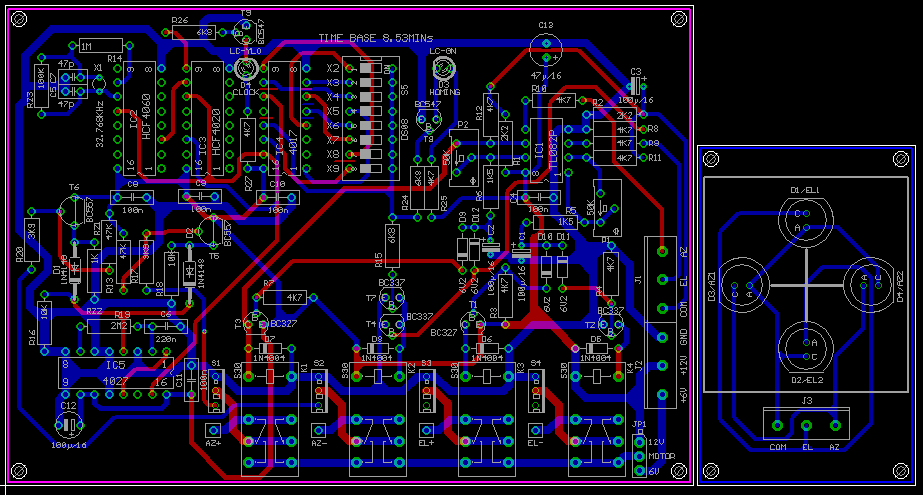

Hi tvp2598,
here is a suntracker circuit which doesn't require a microcontroller.
Sensors are four red LEDs (8-10mm diameter) with clear dome.
The circuit tracks until the azimuth limit switch is reached. Upon activating the limit switch a timer circuit starts counting time (selectable from ~17 to 80 minutes via DIP switches).
When the timer circuit times out the panels are moved towards the sunrise position, thus giving some extra energy even at sunset. (Depending on the latitude time from sunset to dawn might last up to 2.5 hours - at 60deg North and South the sun never sets at mid summer).
Here is the schematic and double sided circuit board.
If you want to build the circuit just PM me your email address. I'll then send you the Eagle files.
Boncuk
  • SOLARTRACKER1-SCH.pdf
