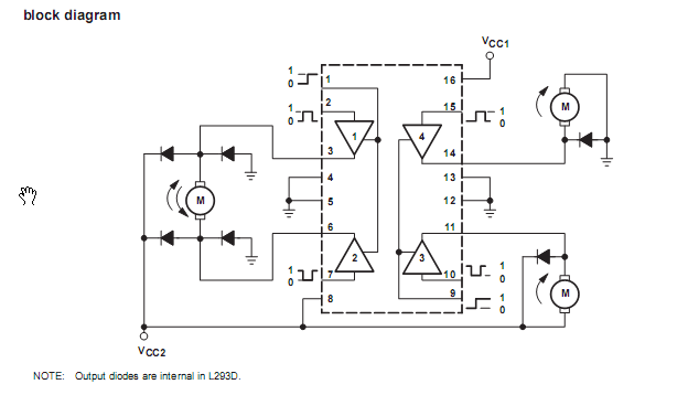

As for the driver used on the schematic, L293D has built in diodes, donno about L293E that they use in the example, but you should need them if you want to protect the equipment (and also if you want to properly switch polarity). Check the datasheet for L293, you will find nice examples there.

About the L293E a friend wrote me: "If you are reversing the polarity via the H Bridge I suspect it is stating that you do not use a back EMF diode. As it would stop current flowing when you reverse polarity. And as such if the H Bridge IC is designed for driving inductive loads (E.g. motor or electromagnetic) it should be able to handle the back EMF.
Is he right? Should I use the L293D instead?

You can add external diodes to a basic LM293, look at this image.
The 4 diodes clamp the voltage spike from the inductor to 1 diode forward voltage drop (about 0.7V) above the positive supply and below ground (negative).

Unless I am missing something I cannot see in that article that he is saying dont fit diodes.?
I would fit diodes on the basic LM293 or buy a LM293D.
Look at the data we have posted, it shows clearly diodes are fitted for inductive loads.
