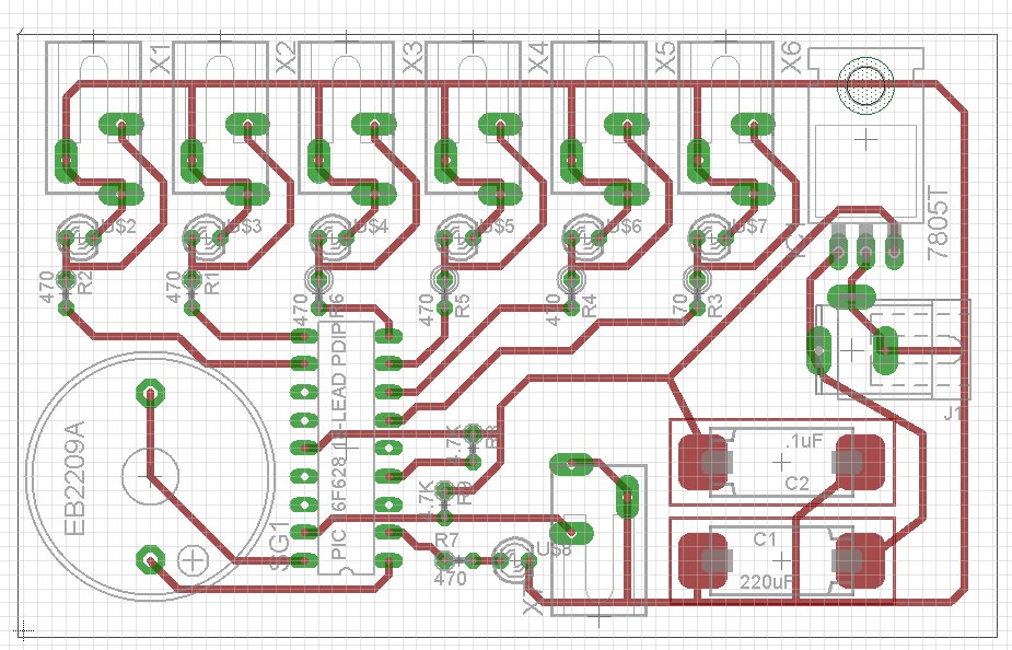

I never posted it, as I built it much after the post thinking it would be a fun project for the kids. I will look for it. It required a mod (jumper or resistor I think) somewhere if I recall. We had a blast with it, then I gave it away (it had a bunch of cords and buttons on the end, so it did not store well. I will look for the SCH/PCB (done in Eagle) and the HEX. If I find it I can zip it and email it to you. If it looks OK, I will post it here. I did it in a rush just to do it. Mind you this was some time ago, but if I still have it you are welcome to it.

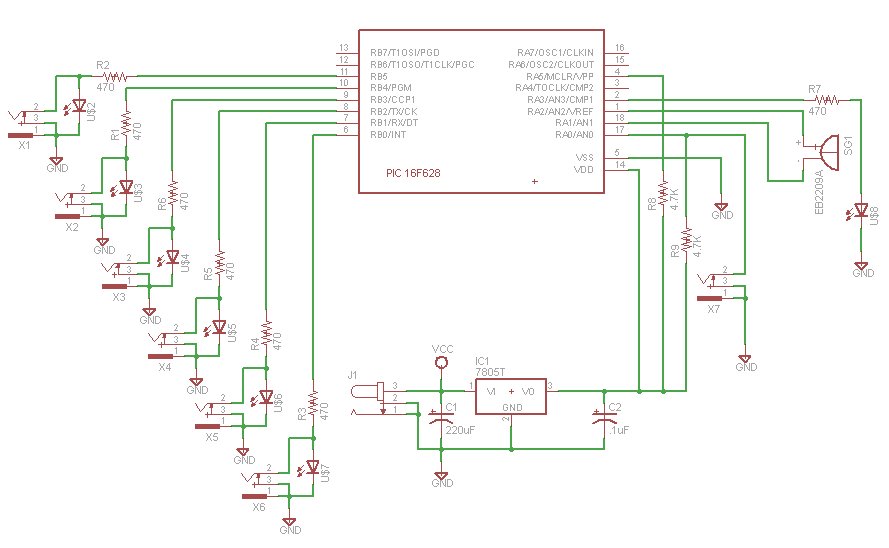

Here is the board. Very simple with a microcrontrller. You will need to download Eagle CAD. I will look for the software and send the source and HEX. It uses a newer PIC so that is a good thing. You will need to get a PIC and program it. No promises, but if I find the code and after I see a picture of your board made, I will (for a small fee; chip and shipping) dig out a programmer and burn a chip for you if you can not get a programmer or someone to burn one for you. If nothing else this will give you a head start on the project. We had a blast with it, I played the host to the kids and wife. I just did a board for a fellow in another thread, since I had not done a board in some time. Just to keep the homemade skills up.

Woah! thank you. Is it possible to use a PIC 16F877/16F877A as an alternative for the pic you just posted. Because the PIC 16F877A is commercially available here and we also have a programmer in school for 40 pins.
If ever it is possible to use 16F877, is there a difference of pin functions between the two?
Looks like I made one in 6/2006 and did the code with Mikroe BASIC (free download of MikroBASIC). We liked it a lot. It had hard soldered buttons on the 2006 board and it did not store well. In 1/2007 it looks like I made a version we could unplug the buzzer buttons/cords. Anyway, it is what it is and if it helps great. Not looking to make another one, the kids are a lot older now and all drive cars :D Did not look at the code, may not even have comments. Basically you have 7 controllers, 6 for the player, 1 for the host to start the countdown. PM if you have a question or two. You will need to make controllers. I had PVC pipe handles with momentary switches in the tops.

Well, if you are in school and have a programmer, I would think this would be a good project. If you change the device type in the compiler and the chip in Eagle, and re-layout the board due to the 40 pin chip. You have the source code, the schematic and free programs on the net (Eagle Cad and MikroBASIC), so anything is possible. Since you stay the in Microchip family it should be a simple task. With all the pins on the 877, you can move the LEDs to separate output as well. Then you do not have to toggle the button (inputs) and led (outputs). From what you have, a few students should be able to clean it up and modify it. The thing would be a lot of fun with friends. Post your changes for others. Other seem to want this. I ad PMs about it for a bit. Was shocked the thread showed back up.

One question please, Instead of the input jacks x1 - x7 ( If I recognized them correctly), can I use push buttons ? if the answer is yes, shall I use Normally Closed as I guessed from the schematic?
Yes, the original was two pad to solder the buttons (momentary switches) too. I added the jacks to disconnect the wired buttons so it would store better than wrapping 7 wires and pvc pipe handles around the PCB. The board posted requires a mating plug, two wires and momentary button (times 7). Number 7 button is for the host to start the games, do not recall the countdown, but should be in the .bas file. You can change it about anyway you want. Sure the code is probably nasty, but it was a just make it work so we can play.
