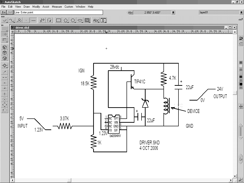

there is some improvements on my project. actully i went to check the load deviceand i checked what it needs exactly.
it needs a current of 4 Amps and 25 volts and they need to feed the current and the voltage in 60 seconds to 200 seconds and they want it to be changed as they want it. one more thing is that it must be linear relation between the current and the time with the voltage also.
any ideas??
if i will use a counter and D\A it will only as a controller cause it can't handle 25 volts and 4 Amps
just want to make sure if i'm doing the right thing.
This is just an idea, I have not tried it. The circuit is a PWM used like a power op amp. The TIP41 puts 24 volts on the "device" until the feedback is satisfied, then shuts off. It goes on and off maintaining an average voltage dependent on the input. The response is slow, but fast response is not a requirement.

if i will make ranges for my project like:
range 1 from 0A to 4A in 60 seconds
range 2 from 0A to 4A in 80 seconds
and so on till
range 8 from 0A to 4A in 200 seconds
which means that i will choose a range and my device will feed the load with the current with respect to time.
do you got any ideas can help improving the project?
