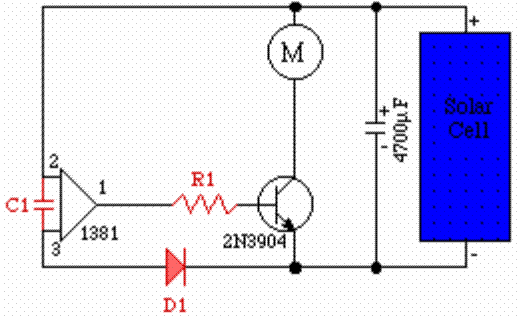

there are some circuits which are used in small solar robots . they work same like i want in this project . those circuits collects power in big capacitors then it will run motors for 1 sec. this type of circuit will be good enough for my project but i do not know the diagram for that circuit. images **broken link removed**
The diagram is given in the instructable page. I show it below. Problem is: it does not "work same like i want in this project". This instructable describes a storage system that uses a few volts DC at several mA.
You have several millivolts AC at an unknown current level, probably a few microamps. The problem, then, is how to convert the minuscule AC voltage to DC when it's barely at the voltage that turns on the best of diodes. Then take that tiny DC and boost it to a level that makes an LED interested in lighting. Then store it in a capacitor before it leaks away. After that, light an LED when there's finally enough.
So here is the instructables circuit. It will not work with your coil.

my friend i know about that circuit and also that how it works but my problem (question) is how to make it small in scale(value) so it can work with my coil ... any idea about that????

what i wanted to say there is that the circuit in the solar robot is very big for my project and it is the same type of circuit which i want but i want it in small size (capacity).

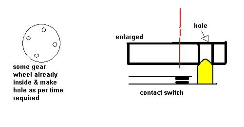

use a brigne rectifier in series with your coil and then a capacitor (rectify), it wll keep on charging to the peak voltage the coil delivers. use another ratating arangement with a micro switch inside. couple it with a gear turning so you can decide the ratio depends on how frequently you have to on and off your LED. (mechanical on off by rotating disk).
so capacitor will be charged in every oscillation and after certain interval LED would be switched on for a while by the mechanism. or until the cpacitor get discharged.
hope it may work.

he has to modify the coil to give enough voltage but less current is ok, the power a pandulum can diliver is very small and need some oscillations to give a charge to lighten a LED for few second. i sugested him to modify it 1st. he can use the idea as attached to build a mechanical switch.
