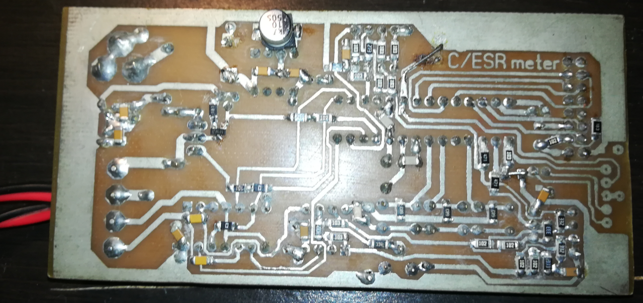

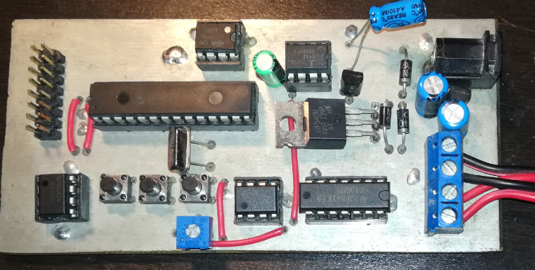

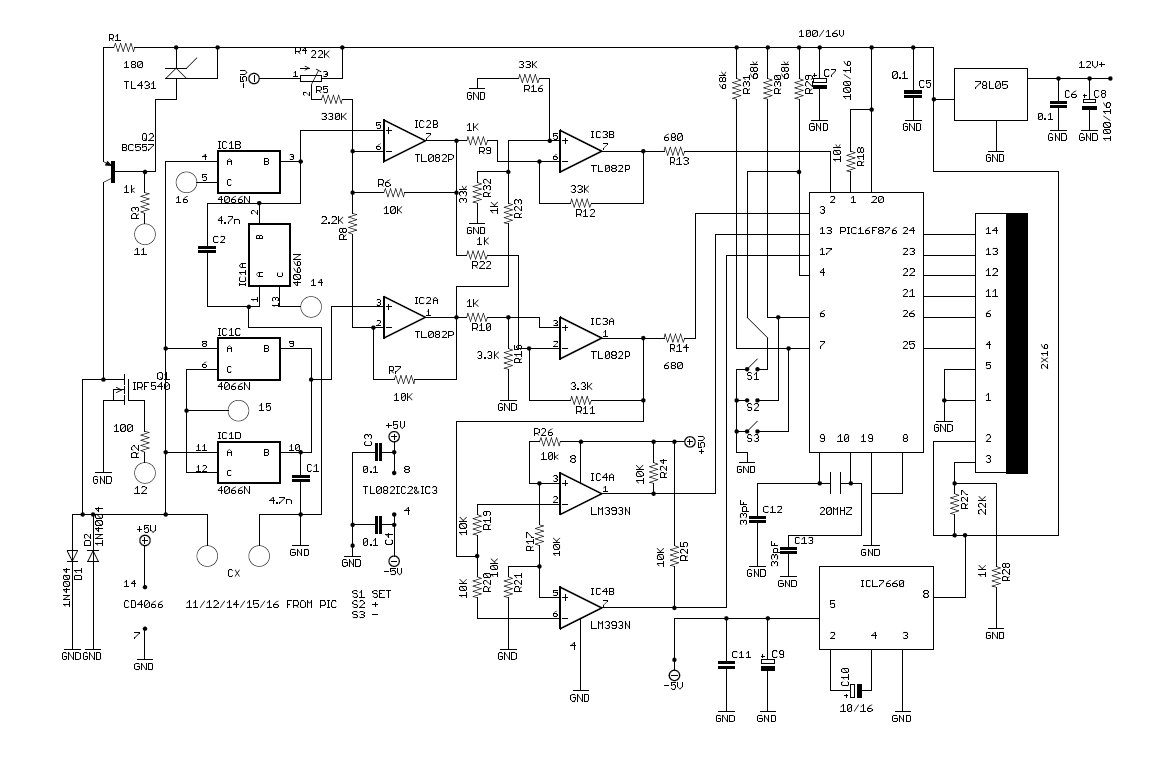

since many years i'm trying to build a functional ESR meter...
up to now i've found online and built 3 different meters but none of them
was a succesful design, the last one i've build was quite complex and seemed
more serious design (as you can see in the attached photos) but it's not working
as it should.

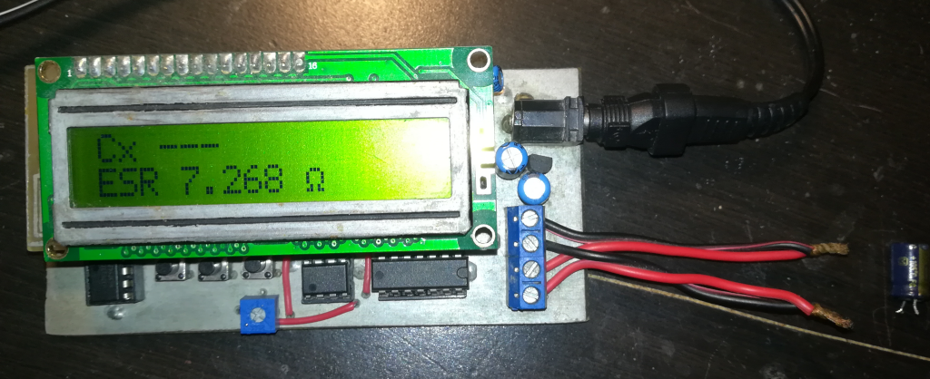

although there is a display output the capacitance indication remains Cx ---
1. tried to look for broken joints or shorts but i found none.
2. tried to measure for an output test frequency i think it should be something like 100Khz)
but there's no output.
maybe the problem is somewhere around the op-amp but i'm not that expert to figure out
by myself, mostly i want you to indicate some test points to check and what i should expect
on these test points, can you help me? thanks!

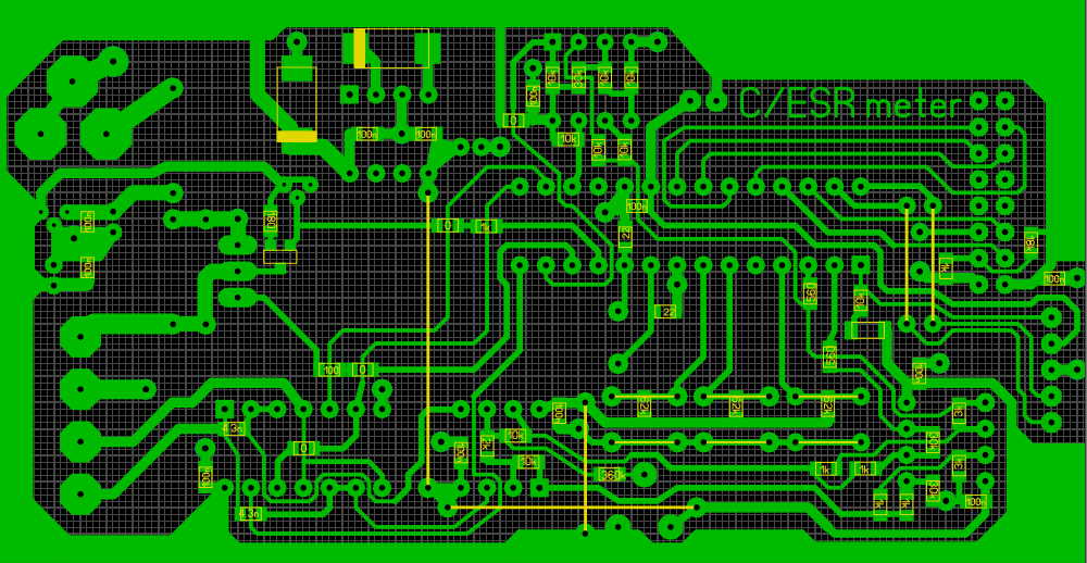

Looks like one of the op amps is in backwards, or the socket is back to front.
Do you have anything on pin 12 of the pic, looks like that is the test frequency.

Which IC looks like it is placed wrong way? because i think all of them are placed right.
Testing different capacitors the ESR indication changes, although the capacitance
measurement it's always Cx ---
The 8 pin chip to the right of the preset looks backwards.
Pin 12 is the drive to the output fet, without this you wont get the ac on the test terminals, a scope would show you a square wave most likely, a meter would show you the average dc level, and a logic probe would show a pulse.
If theres no ac on pin 12 then it might be something as simple as the device is not in test mode or something, maybe you need to initiate a test by pressing a button or something.
the ESR measurment seems functional though....but i'm not sure if it is accurate
The TL082 black dot which indicates pin #1 matches the square pad on the
pcb which also indicates pin #1, isn't it??
