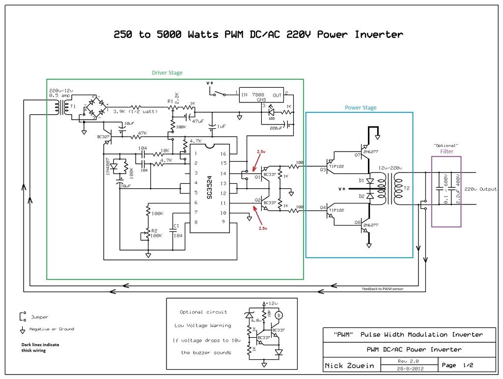

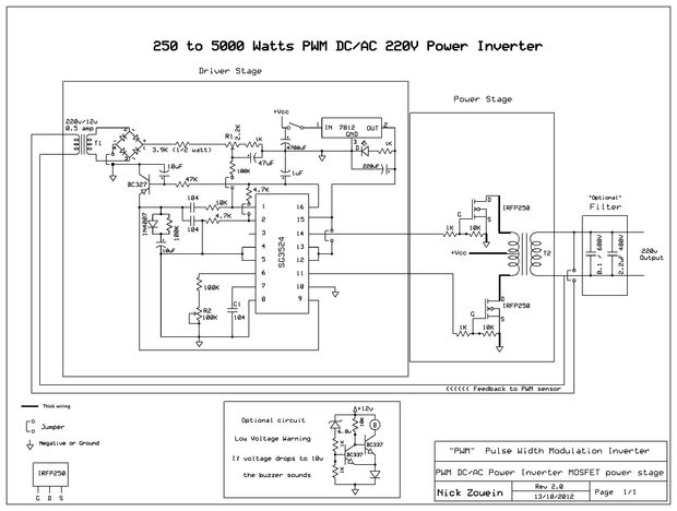

Relating to what I have said earlier about using a common LM3524 or SG3524 Ic and a set of High/low driver IC's to make a simple H-bridge inverter.
With mosfet power stage.
With Transistor power stage.
Here's the link to those circuits and their related build data.
https://www.instructables.com/id/250-to-5000-watts-PWM-DCAC-220V-Power-Inverter/
The only difference here is that the as shown designs are for push-pull power stages so that end of the circuit would be replaced with the driver IC's and H-bridge.
The only downside or concern here would be that the DC power source needs to be capable of supporting more than the continuous duty power consumption of the pumps which if yo have 500 watt pumps running at 800 watts the supply side had better be capable of supporting at least a 1000 watts for extended periods and 3X that on pump start up which rules out direct solar panel drive.
