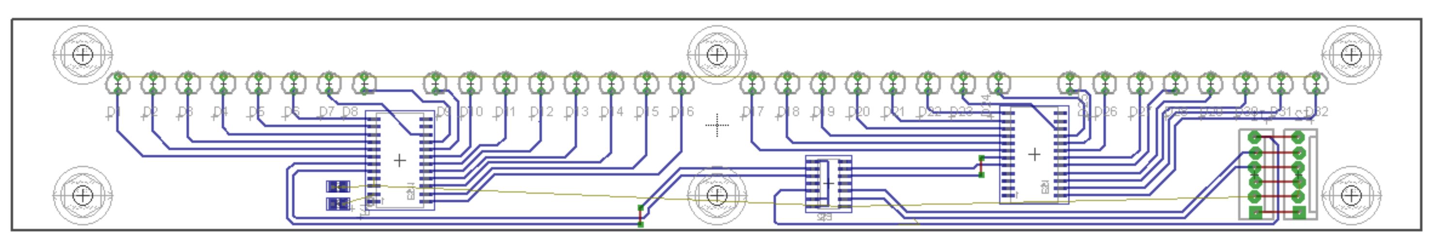

I decided to use the IS31FL3218 that Spec suggested, along with an I2C multiplxer. It adds some steps in the software to address which bank of LEDs to use but that won't add much complexity. Compared to the PCA9532 that Granddad recommended or even just an MCP23017, this saves 16 LED current-limiting resistors. This panel is used as an indicator panel in rack that will rarely be looked at, so the flashing/dimming features of the PCA9532 really don't add much to the design.
The picture shows the nearly completed board layout, designed for a 1U rack enclosure. The board lays out pretty nicely with these components.

The PCB looks pretty neat

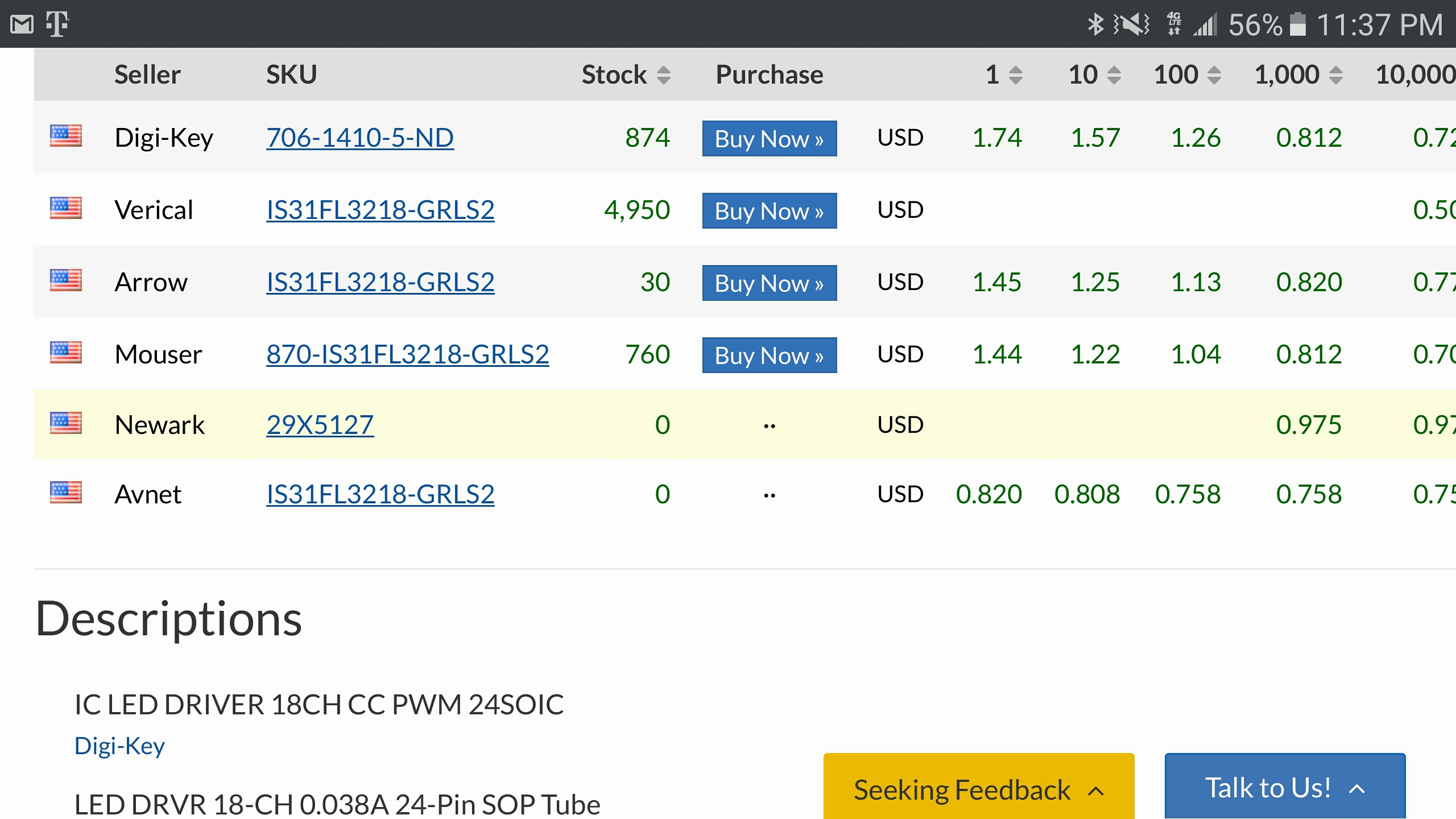

Around a buck and a half. Good stock available too.
Here's what Octopart says:
