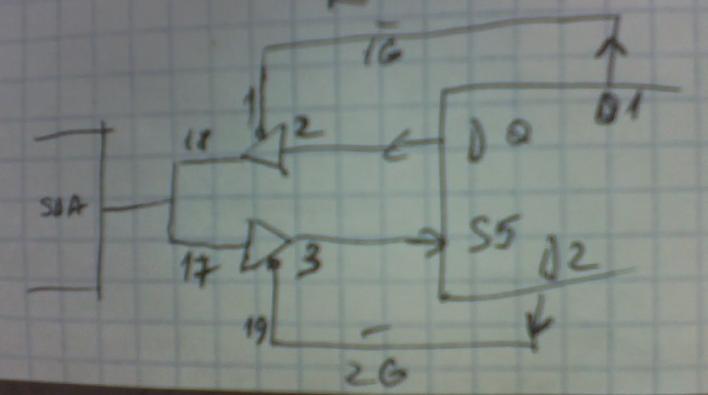

For testing im using the parallel port in EPP mode. I made some software I2C routins, which I use for sending data according to datasheets, and it worked very well from start. However I spent almost 2 days trying to receive data from the IF IC (TEA6820) without any success. Im using a 74LS244 tri-state bus driver, checked the hardware separately and works fine.
By applying a slow clock rate, I can debug the whole reading process, and realized, that the IF IC does not react at all, the SDA line remains high all the time.

I attach the schematics for SDA, maybe this will help?
Regards.

Sorry, but i think i don't understand you.
The first AM IF is 10.7MHz
FM mixer for conversion from FM-IF1 = 72.2 MHz to
FM-IF2 = 10.7 MHz
AM mixer for conversion from AM-IF1 = 10.7 MHz to
AM-IF2 = 450 kHz
I dont understand how to program the front-end IC TEA6811 to obtain the desired frequency. The TEA6820 contains the second mixer 10.7->450KHz, and I dont need the 2nd IF counter value.
11111001 for 1st byte means 25KHz step, mono!
If you were thinking about 2nd byte, then divider for mixer2 would be 2, which should be 6 for 10.7MHz IF1. Page 13 Note 7.
