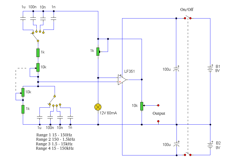

here is the circuit of a classic Wien-bridge sine oscillator. Regenerative feedback is gained by the 12V/60mA incandescent lamp.
Select an OpAmp you need for your requirements.
Boncuk

Another way is using a DDS function generator chip like the AD9834.
Selecting the AD9834CRUZ (master clock input 75MHz) it will certainly produce a clean sine wave of 3MHz.
Using the AD9834BRUZ (master clock input 50MHz) you'll have to prepare for some distortion.
Use an appropriate filter for the desired output frequency.
Boncuk
Thankfully, I only need .25 -> 3Hz then variable amplitude 0 -> 5V (or close) for ADC uC input.
