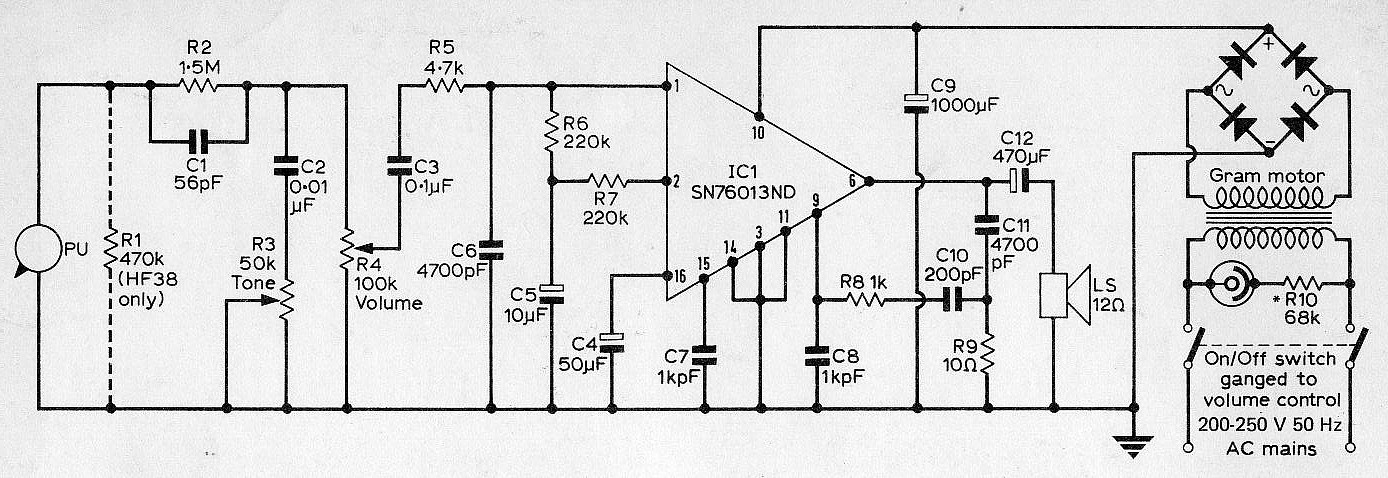

Well the specs have already been mentioned above, and even a diagram posted - I see the 33 is the one with external gain components. Here's a 013 circuit with has internal gain setting components.

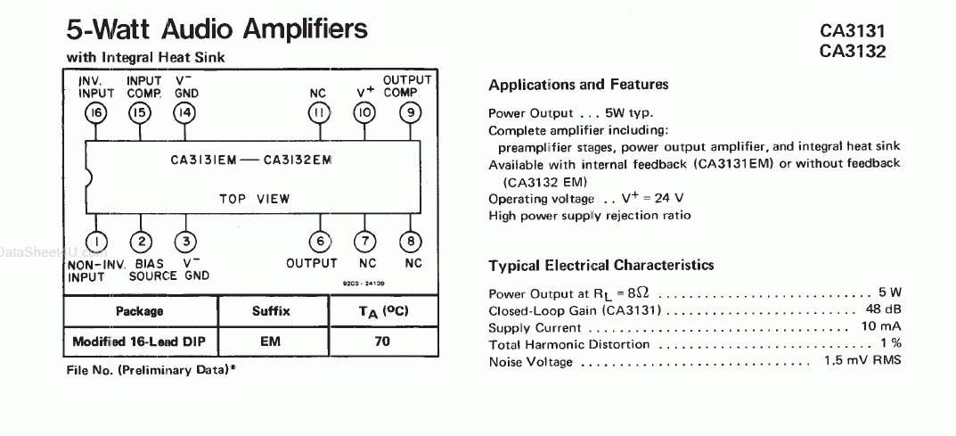

SN76033 AF amp 8W at 35V bass and treble 12 OF 16DIL + HEATSINK
Hmmmm Possible Substitute?
Hi John.
Hmmmmmm indeed.
I have my doubts about pin 14, and pin 16 can't be found at all on the SN76033 schematic.
But it is worth putting on file. Thank you for another part of the puzzle.
