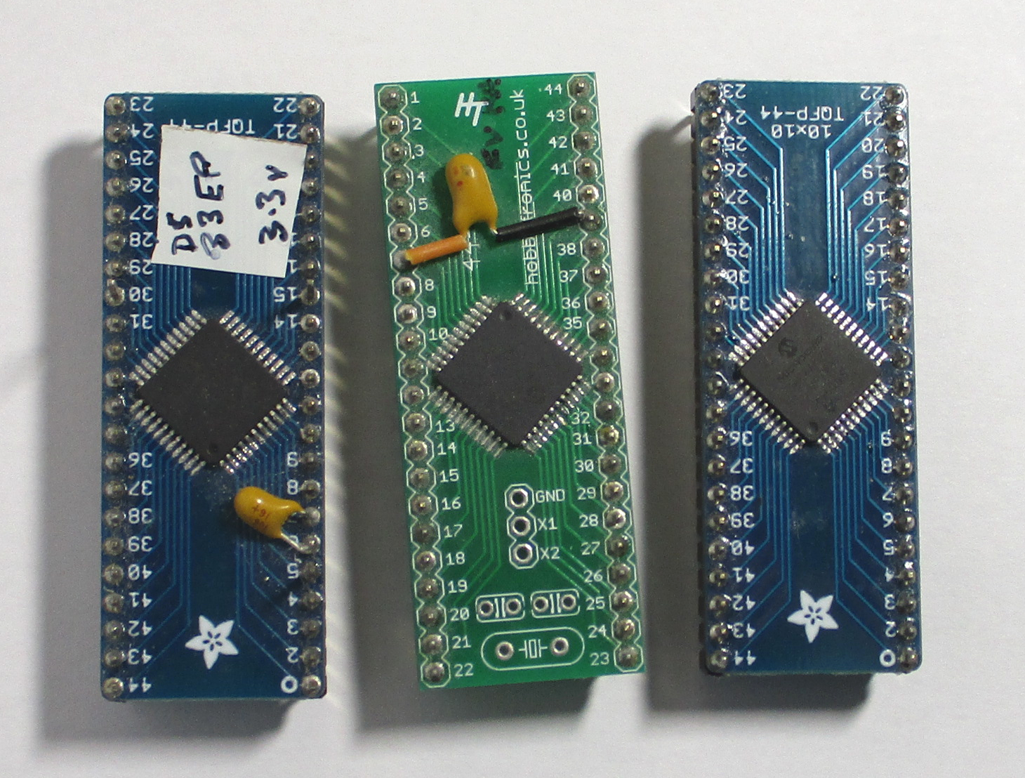

Hi C I did venture into Arduino world. but wasn't for me, as i was grappling ( still am ) with PICs and MPLABX and C I as a result now I fabricate various flavours (44 pin TQFP ) onto BOBs.. then drop them on to a breadboard to see if my ideas work . Having 37ish IO and PPS (pheripheral pin select) make this arrangement very flexible .
