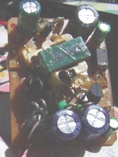

ID a zenor diode
if you reverse polarity connected the battery to the output
The adapter is new, never used.
The only thing I did was test the voltage to make sure the center pin in the plug was positive and that's when I discovered the low voltage, about 1.8 instead of 3vdc.
The vendor has refunded the purchase price so I am just trying to gain some experience working on it.
There are four connections on one side of the transformer and two on the other but I'm not sure what I should be seeing on any of them.
I looked for the reference numbers Hi Pot 66015620, RO1 SC22, 155-10A, c828-03 but didn't have any luck.
I pulled it out of circuit and used a digital multi meter with a capacitor function.

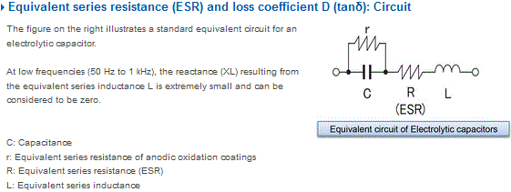

That's not testing it at all, as I said the only way to test them is with an ESR meter.
When capacitors go high ESR (which is almost always how they fail) the capacitance doesn't usually change, or at least not enough to be out of spec, so a capacitor meter, a capacitance bridge, or the capacitor range on a multimeter will show a faulty capacitor as OK.
But assuming it's actually like the circuit you posted?, it will work perfectly fine without the zener in circuit - it's only there as a safety measure, to go S/C, if the output goes too high.

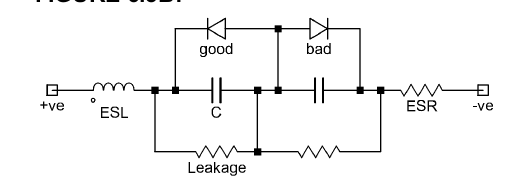

? both polarities - what you should check is use 20kΩ region and alernatingly charge it in opposing directions (while doing so note that you won't discharge it with your at worse about 18kΩ skin resistance) - what you should see is ohm-meter showing up some resistance that fast fades to infinity (. 1 on LCD) - if it doesnot fade to ∞ then there's a DC path through it in that direction
It's a component which commonly fails in these PSU's (because they use a cheap lo-spec capacitor), and failure of that capacitor will blow the crowbar zener.
what Mr. N. said is that the cap smoothens* out a current peak from TF (so the zener has to deal with now* already a way lower load) -- so if the cap has too high ESR or is "dead" then all of the previously said doesn't occur and your zener is on it's own

It's far worse than that, the electrolytic is a vital part of the entire PSU, with the capacitor high ESR the output voltage rises (considerably), this will cause the zener to do it's job and go S/C.

My meter only has a 40k range but at that the capacitor will show a fluctuating reading then fade to 0.
Reversing the leads is the same.

UPDATE
I used the esr meter to test the cap and compare it to a new cap and there was a difference so I replaced the cap and zenor, the 3 volt adapter is now producing 3.54 volts dc.
The cap still seems excessively hot but I'm going to heat sink it and keep a close eye on it.
The capacitor is generating too much heat, something else is causing the problem so it's headed to the garbage after I pull and test the other components.

Is there a method to test this transformer if I don't know the voltage in or out?
There are four pins in and two that are for the output supply.
It belongs to a 3vdc ac/dc wall adapter.
