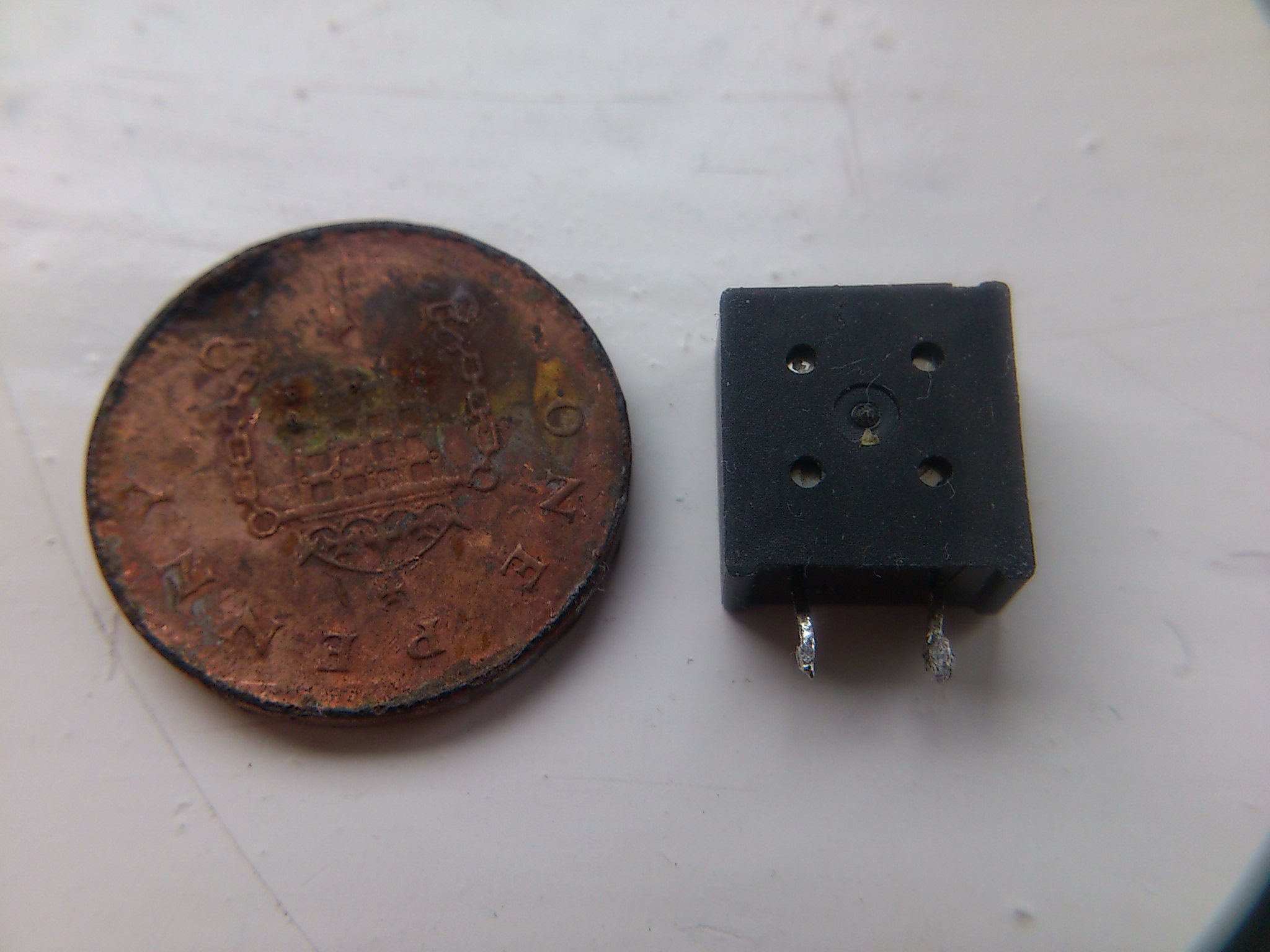

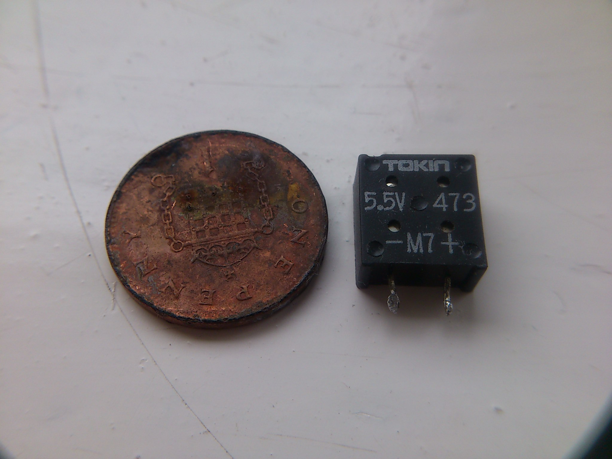

5.5V 47nF capacitor, I would guess.
I suspect the 473 means a MUCH higher value than that
I agree, but, that is a very large package for a 47nF capacitor.That's a standard code, the code is for picofarads. 47 000 pF = 47nF
And the 5.5v rating? a bit low and precise for the average capacitor.
And polarised? a 47nF polarised capacitor? a new one on me.
A "super cap" sounds more likely.
I don't think so. That's a standard code, the code is for picofarads. 47 000 pF = 47nF (Nigel, I know you're familiar with the code, I'm saying this for the benefit of the OP). I don't think the code on this device is different.
In my experience, the majority of super caps pulled from PCB's are either dead or about to.
All my experience of 'super caps' (a stupid name! ) is replacing faulty ones, they are really exceptionally unreliable - I certainly wouldn't ever think of removing one from a PCB to reuse (or indeed ever think of using one in the first place ).
