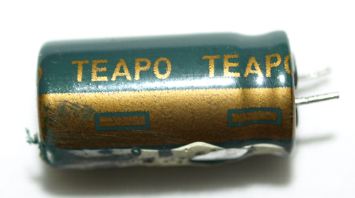

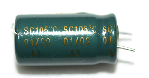

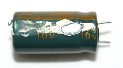

Identify this CAP Teapo pics included.
HyperionShrike
Can anyone identify this cap? It was glued down and it just so happens right over the uf. On my ESR it's value is 115uf but if you look carefully you can see a 22 just before the glue.

What type on ohm meter do you have, mine has a capacitance meter in it, but on larger caps, I have to measure the time it takes to go OL (out of limit). Short the known 220uf and measure it's resistance and the time it takes to OL or infinite, now repeat on your unknown.
