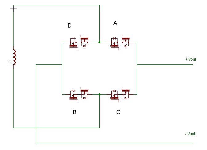

A diode replaced with MOSFETs and a zero crossing detector is sometimes referred to as a "synchronous rectifier". A PIC will not do this very well, a comparator will. Op amps can sometimes be used in this capacity too but it depends on some specific details of the device.
Your device needs to be hooked up to a switching mode regulator, it might be a buck, boost, or buck-boost depending on your needs. It is possible for a PIC to do this but an off-the-shelf converter is probably better. This will allow you to put out a constant voltage as the capacitor voltage drops, and can do so quite efficiently especially if you substitute MOSFETs for the schottky diodes. This is considerably more tricky but results can be nice. BTW, the PICs with "Enhanced PWM" like the 18F1320 have special outputs for driving the synchronous rectifier. Since the PIC sources the PWM signal it does not need to sense the current direction with a comparator. But the freq needs to be high and the PWM needs a decent resolution at high freq. The PIC may be a bit problematic with its resolution at high freq, and they use substantial idle current to keep going at 40MHz.
If a boost or buck/boost converter is used, you would be able to continue to produce 12v for example while the cap voltage is only 1v. This greatly increases the effective size of your caps while eliminating the voltage regulation issues. You can potentially replace the series array of caps with a parallel one too, which may or may not be helpful.
The bootstrapping issue with the boost converter here is that the regulator's logic requires more than 1v source to run. You could source it off of the output (12v), but then it has no way to start itself when the output cap is uncharged. Adding a lithium coin cell or two used only to get it started will solve the issue beautifully and will last basically forever.
ya think this would work?
assuming i could get the zero crossing detector to drive the fets at the right time and with the correct voltages
there are four pairs of Hexfets , each pair would have their gates tied together..
when the top line comming in from the coils is more positive than the bottom , A&B would be on & C&D would be off and visa versa...
with todays low Hexfet ON resistances i think i could expect LESS than 40 milli Ohms per " on " leg...
