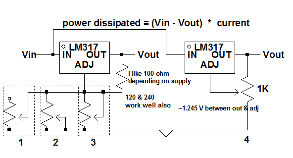

Basically, I can't get the output voltage down to less than +18. I need a 0-3 vdc voltage source. Then I can try to get the current down to less than 0.5 Amps.

a LM317 need about 2 volts more than the desired output to work and can not go below 1.24 volts, so it's probably not what you want to be using.
what is you power supply, what what is your goal?
there are several ways to connect a LM317 here's 4

Kinarfi's right, 1.2 to about 30V and not 0 at the low end.
You MAY actually want a variable REFERENCE rather than a power supply? A reference is stable, but usually cannot source or sink much current.
If the input is 18V and the output is 2V at 0.5A then the poor little LM317 will be dissipating (18V - 2V) x 0.5A= 8W which is a lot of heat so it needs a pretty big heatsink.
When the trimpot is set to 1k then the 240 ohm resistor has 1.25V across it so its current is 1.25V/240 ohms= 5.2mA and the 1k trimpot will have a voltage across it of 5.2mA x 1k ohms= 5.2V. Then the maximum output voltage from the LM317 is 1.25V + 5.2V= 6.45V.
Why is the input voltage so much higher than 3V? All it does is make lots of heat. For a maximum output of 3V the input should be about 5V then the heating when the LM317 output is at its 1.25V minimum is (5V - 1.25V) x 0.5A= 1.875W and only a small heatsink will be needed.
