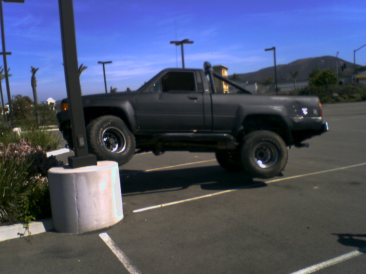

Hi everyone, for those of you who remember me, it's been a while. I got into fourwheelin and have been having so much fun with it electronics sorta got put on the backburner!:D There's a picture of my 84 Toyota 4x4, it's got a solid axle with 4.88 gears and Aussie autolockers front n rear, which lets it go anywhere, I've installed an MSD ignition, weber carb, flowmaster exhaust, just to name a few, and in the next couple of weeks am going to fabricate an exocage for it, and after that do a 3-link suspension with coilovers up front.
