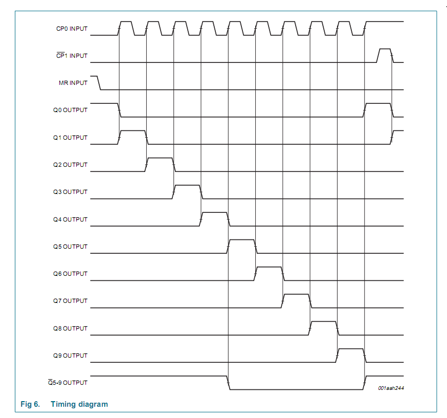

Look at this clip from the datasheet.
Note: Q0 is ON when the 4017 is reset, so count from there.
q1,q2,q3,q4,q5 = ON, q6 = reset

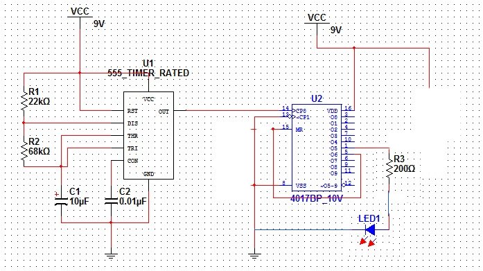

Where did i made mistake ?
It should look something like this...
555 has output f = 1Hz
Your drawing shows pin15 [reset] connected to 0V., it should only go to the 4017 output.

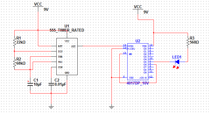

I did what u said.
I think i need to change R3=560 Ω
But it still dosent turn off on every 5th impulse. Something else is wrong too

Whats the sequence of the LED that you are seeing.?
EDIT:
Pin 5 should only goto pin 15, no where else

LED is ON all time
With the LED connected that way, it will be ON most of the time.!
Connect the resistor to the 4017 pin, not the +9V

Nope same thing.
I know that LED will be on most of time. It only must turn off when 5th impusle comes at input of 4017
I will post you a full circuit diagram tomorrow OK
Nope same thing.
Well with the circuit you have posted it will work as you want.
As I said I will post you a tested circuit tomorrow.;)
