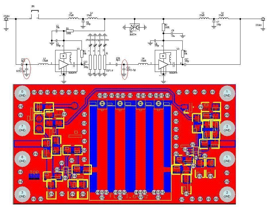

I was having trouble with my GPS nav system in my car loosing the sat signal during rainy,cloudy and stormy conditions. So I designed this inline GPS amp using a device from Maxim. **broken link removed**

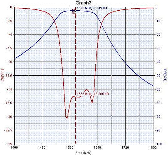

Below is the circuit, pcb layout and network analyzer response. Works very well. The SOT caps on the input were selected to improve the noise figure of the device.

I would like to know if you still have the schematics files of your desing and I want to know if you can share them with me.
I can see tha the circuit has like an array of LC filters conforming the antenna, and I wonder if it was hard to tune the antenna with the those varicaps. Wich procedure did you use to achieve this?
I suppose I will need a field meter (I really don't know if thats de correct name in english), and that it won't work at fist time without calibrating it in a lab.
Sebastián
This circuit will be very difficult to align without a RF network analyzer (RF tracking gen and spectrum analyzer combined)

I understand as a self amplifying antenna as an antenna module with a built in amplifier, thus it is not a pasive component. And that is what I am trying to do. I think that an amplifier is a must have in my case, ´cause what I am building is a reradiating antenna.
Of course that the practical way maybe is to go and buy one....but I don´t like the easy way 8) And here in Argentina is very expensive.
The problem is that I don´t hace experience and the knowlegde needed to build the right PCB. That´s the reason I am asking for help. Then I will need some help to tune it up.
