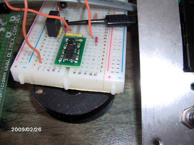

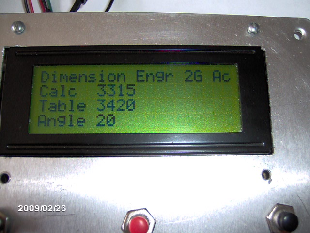

Here you go.......... first lag at a sin table value, using the Dimension Engr. DE-ACCM2G sensor in the y-axis. It doesn't sound like the you can be convinced this will work, so I will not try.

The acceleration of gravity is always there, colin, and the accelerometer measures that. You put two at right angles to determine the vector. Doen't matter if you're rotating it or not.

If you are saying that if you put the sensor on the table and it will not measure anything because it is not moving - you are dead wrong ... (check the picture nickelflippr showed to you) ....
I also use accelerometar as a tilt meter .. completely stationary, the whole thing is that if you "move" it you lose precision as then it calculates "movement" + gravity...
so, you put it on table, flat - it show valueX, you tilt it 2 degrees (and leave it tilted - do not move it) it show X+dY ... if you measure it in 2 known positions you have very accurate "tilt meter" (under 1 degree accuracy)

colin, Measure the static acceleration of gravity in tilt-sensing applications .... donno what more positive you want ...
on top of the documentation ... I have it here, on the table, it measures tilt not while you are tilting it, it measure tilt by "being still on the table" .... it is not moving relative to anything in the room... (it is moving relative to the stars but that's not what we are talking about right) ... the accelerometer that is stationary relative to earth show different measurement depending on the tilt toward the earth. ... donno how more clear I can tell you that ..
- you place it on the desk, it does not move it show 0 degrees
- you place it on the desk tilted 10 degrees, it does not move, it show 10 degrees
This is not "reading / decodeing / understanding" documentation, this is real life experiment with the board I gave you link for. I have no idea what is in the chip, how it measure the gravity / what technology it uses to measure it ... but it does :)
