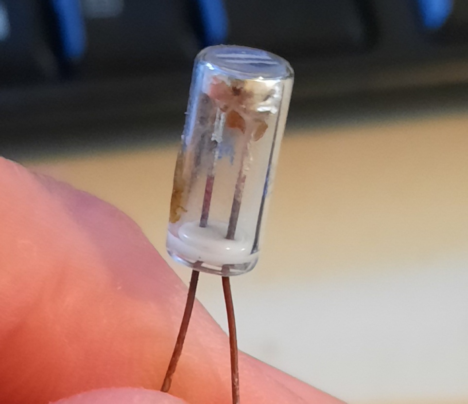

be80be Well-Known Member Aug 8, 2020 #1 Indicator bulb trying to find the data on these bulbs maybe neon I don't have many so I'd like to get them to light the first time

V Visitor Well-Known Member Aug 8, 2020 #2 If it is neon, the resistance across it will be very high when it's not operating. If the resistance is low, less than a few ohms, it's probably incandescent. If the resistance is very high or open circuit, it's likely neon.

rjenkinsgb Well-Known Member Most Helpful Member Aug 8, 2020 #3 It looks like an INS-1 **broken link removed** Edit - 65V operating, at 0.5mA Data in this article: INS-1 - Tiny neon bulb tubehobby.com

V Visitor Well-Known Member Aug 8, 2020 #4 Nice call rjenkins. It's a nixie tube. There's some discussion about them here, including a link to a Russian datasheet.

be80be Well-Known Member Aug 8, 2020 #5 I was going through some stuff I have and found them I was thinking neon They basically open 0 resistance

Nigel Goodwin Super Moderator Most Helpful Member Aug 9, 2020 #8 be80be said: Well 120 volt Ac doesn't light it Click to expand... Did you use a high value (100's of k) series resistor? (or you 'could' have instantly blown it?). But assuming they are nixie?, and not neon, then you might not have enough voltage to strike them.

Nigel Goodwin Super Moderator Most Helpful Member Aug 9, 2020 #10 be80be said: yep 220k Click to expand... Get more voltage on it then Stick a voltage doubler on your low voltage mains.
