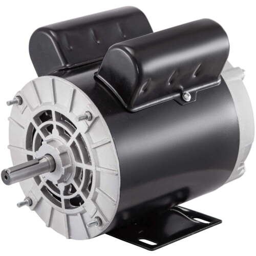

I'm trying to fix a log splitter that got left in the rain. The motor is a capacitor-run single phase induction motor, with a rating between about 1 kW and 2 kW. It's about 20 cm diameter over the cooling fins.
The armature had rusted and jammed, but I have freed that off and the motor runs fine, but I still have a problem with earth leakage.
I've got the stator separate from the rest of the motor. There is about 2 mA leakage between the windings and the lamination at 240 V ac. When measured with a multimeter there is something electrochemical going on. In one direction it reads about 3 MOhm, and in the other direction, the reading climbs to about 20 MOhm, and when I immediately read the dc voltage, it's often above 2 V, and decays to zero. The multimeter puts out well over 3 V when measuring high resistances.
Although there is some rust on the laminations, I can't see any damage to the insulation around the winding bundles, but of course it's difficult to inspect everywhere and I can't get to look at most of the insulation without destroying the windings.
Any suggestions as to how I could deal with this without getting it rewound?
As Max says, cook it thoroughly to ensure it is absolutely dry.
You could then try running some heat-cured epoxy down each stator slot? That can be given plenty of time to help it penetrate any gaps or cracks, then fully heated for a final "flow" in to fine cracks and to set it solid?
example epoxy type
That could work. I would be worried that there could still be a void in the epoxy that contained water / ionic contaminants.
Agree with Max that a Megger or a hypot tester should be used to ensure that the original insulation hasn’t been degraded.
The Megger tests at HV, which is required to test insulation, an ordinary DMM pales in comparison for that task.
The electrolytic effects with the apparent leakage resistance dependant on polarity & it producing a voltage between the windings and casing imply the insulation has failed at some point?
That's why I think it's worth trying to add further insulation via the epoxy; I'd not try a high voltage test until that has been done.

I have baked it at 80 °C for a couple of hours. The leakage current at 240 V has dropped to about 0.9 mA. I'm going to try a couple more hours.
0.9 mA isn't perfect but it's probably good enough. If the insulation does get worse all that will happen is that the RCD will trip.
The best fix would be to get the motor rewound but I don't know if anyone does that any more.
