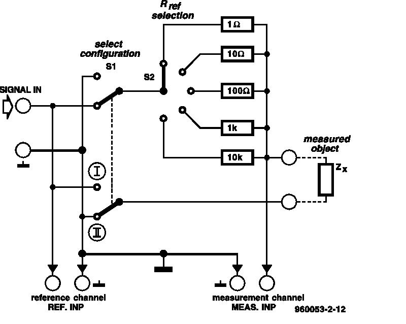

I tracked down the Elektor project, the parts are 5 resistors 1R,10R,100R,1K,10K and 2 switches a DPDT and a 5 position rotary. I have the software. The measurement range claimed 50uH to 10H and 100pF to 100,000uF and will display input/output impedences of filters. The big problem is that it is a DOS program written by a mathematician Dr Olfsmann and I haven't tried it with XP. I don't know if the Dr is still with us.

This is the circuit, obviuosly the software does all the hard work
