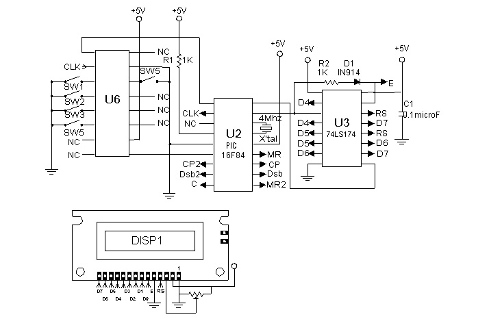

Hi
Ive build a counter routine using a PIC16f84, just a basic counter and LCD at a press of a button the counter starts from 5 down to 1 then stops and it's diplayed on a LCD. when i use a 9V battery as supply it's ok but when i use the variable supply at my school it starts to count even without pressing the button wat am I doin or not doin right ive tried a couple times and it still has the same result the counter starts immediately after i turn on the supply.
thank u :D

Try posting the circuit diagram, it sounds like you may not have wired the switch properly?.
Here's the partial routine for U6(SN54HC165)

Shouldn't there be pull-up resistors on U6's inputs to keep them high when the switches are not pressed ?

I've never used that port expander chip, but generally you need pullup resistors on the switches - so I should try adding those and see if it helps.

I have had a similar problem before,(works with a battery but not with a wall wart or mains power supply) mine turned out to be "dirty" power
a 100uF cap sorted it out........just a suggestion
:lol:
I've had power supplies that have actualy put out AC power when they were to be DC. If you can check the wave of the power.
Add caps, Pics like clean power.
Kent
Your circuit seam to require 5V power, how do you power it from 9V battery (or the regulator is not shown?)
Or, three 0.1uF as close to the power inputs to each chip may also resolve, but I think it's the lack of pull-ups combined with noise in the supply.
