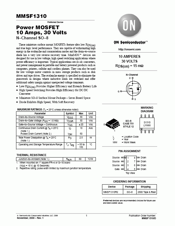

info/dataheet for SF1310
  • SF1310-D.pdf
A Picture would help alot.
I was just going by Numbers and a Very Very short Discription of the part.
