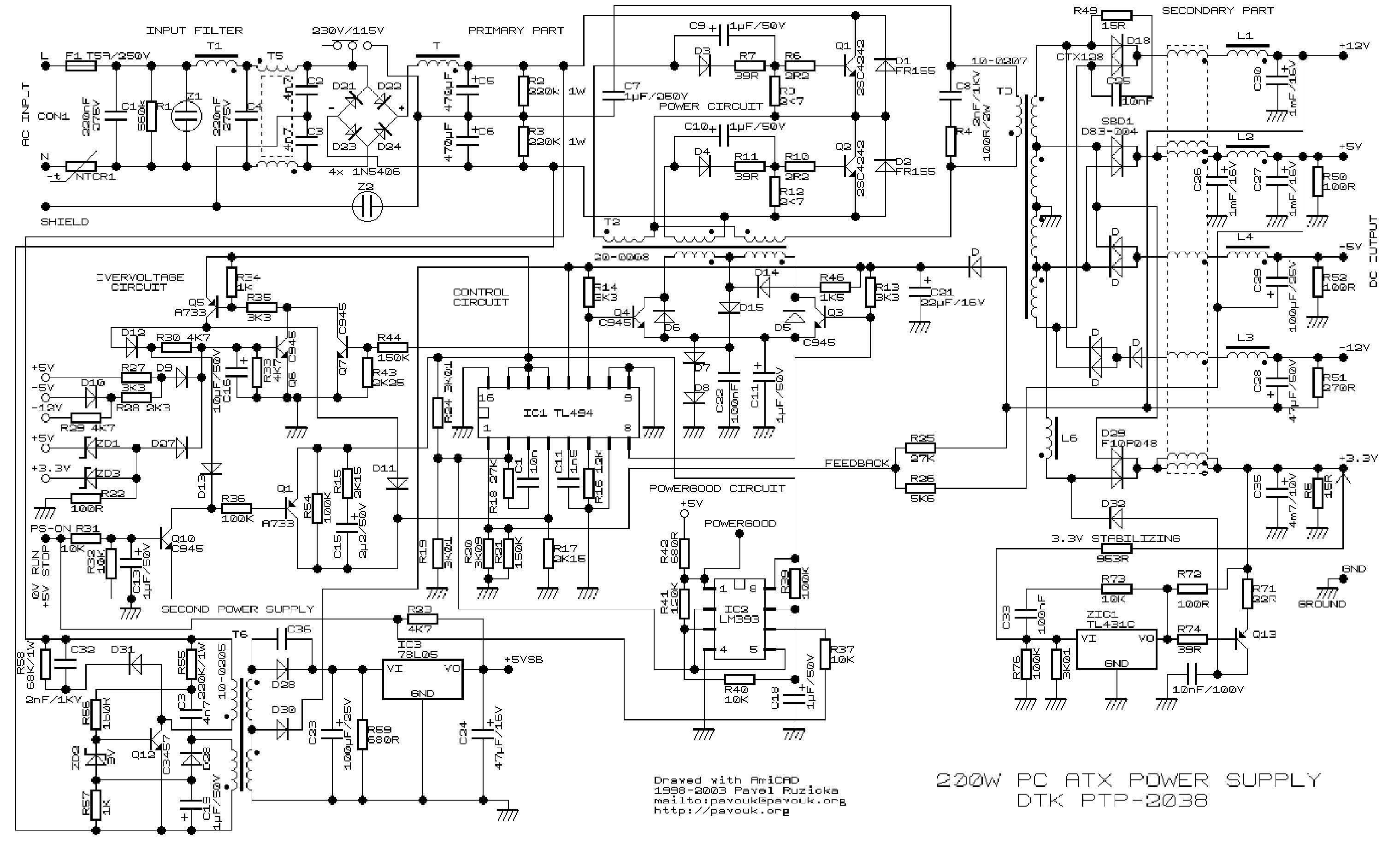

The TL494 is used extensively on PC ATX power supplies. Obviously, it has be able to shutdown in these circuits.
Attached is typical ATX power supply schematic.
Shut down in the usual sense where the IC is brought into a mode of low power consumption? then the answer is NO.

hmmmmmm guess pin#4 IS the WAY? to shutdown??? :rolleyes:
need to see more TL494 application notes....
