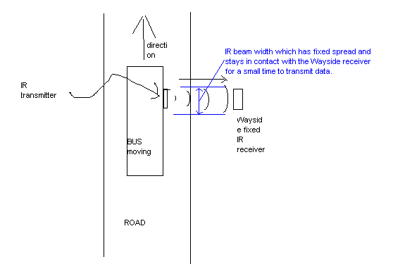

I dont have experience wit IR communication . I am employing it in an automotive application BUS Transit . I intend to communicate directionaly the status of fuel/coolent inside the BUS from side ways through fixed transponders .
The Bus may be at 60Km/H speed but distance is less 2meter . Is it possible to collect data at this speed with IR system? . The data being 6 digit number. I am unable to use RF as it isnt directional and will confuse between two Buses as the onboard transmitters will always be in ON state working as simplex configuration to cut the time required in protocol exchange. Also from so many Buses it would also be difficuly for RF fixed transponder to maintain a search and slave enumiration .

Actually what I am asking is regarding the stable 'Infrared carrier generator ' and does a 555 timer fits the industrial application bill? or a XTAL controlled is required?.
Is it be possible to relay the information from a moving vehicle to a wayside transponder using Infrared serial link , I mean It takes less time for the vehicle directional link to passby the fixed transponder(receiver) . Drawing I tried to explain here;
ir-gif.27388
Now as it can ve seen in the drawing the transmitter stays in contact with the receiver for a small time , hence can we transmit the desired information that quickly. The vehicle may be moving at more lower speeds say 20Km/Hr.

At 20Km/Hr the bus would be moving at 5.6 meters/sec or 180ms/meter. Thus you would have 180ms to read the data if you assume you can read it during the time the bus moves 1 meter, which should be more the sufficient. You could send the info in RS-232 serial port format, which should be fast enough and which many microprocessors can support. A microprocessor typically operates with a clock crystal that precisely generates the transmission frequencies.
You could send the info as one sync byte (say all 1s), one or two fuel bytes, and one or two temperature bytes. You continually resend this sequence.
This is an out-doors application so you're gonna want some really bright IR LED's for transmission, and a solid receiver setup. The receiver is going to potentially need to deal with near saturation conditions (sun shining at it) and still be able to detect the paltry output of an IR LED.

Along with that, a lens in front of the detector to limit the view angle, as well as an IR (pass) filter to block out visible light, will likely also be needed.

The IR method was used/tried on London transport buses about 25 years ago.
On some of the pavement poles they mounted IR scanners, on the bus side they had retroprism flat reflectors.
The idea the scanners detected the bus ID and the location of the poles, the data was sent by radio to a central control, this way they had a good idea where the buses where..
Its now been surpassed with RF technology.
Ref, the ultra sound, at speed or in a wind the ultra sound beam will get 'blown' away...that is bent away from the detector.
Also the data transfer rates will not be as high as IR could be.
