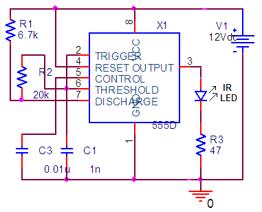

Here is my circuit for the transmitter with a pspice output. The D1N4148 is the IR LED. The simple receiver circuit I used is the device itself tied to Vcc (5volts) ground and the output. Do I need a specific circuit for the receiver or is this already included in the receiver device (module)?

Right, it is, but I was wondering how to model it in pspice so I used the 1N4148. In my test circuit, done in my lab, I used a couple IR LED's; allelectronics.com, CAT# ILED-8.

You connected the IR LEDs wrong so you burned them out and maybe also burned out the 555. Maybe you are lucky if the battery is dead.

Oh I see yeah the circuit does show it backwards, but I did connect it correctly.
The resistor is in the wrong place.
The IR LED has a max allowed continuous current rating of 100mA or 200mA for very short pulses.
But the max allowed output high current of the 555 is 200mA and it will try to supply 1A to blow itself up and also blow up the LED. The 47 ohm resistor adds even more current to the LED.
When the 555 tries to go low then the 47 ohm resistor will have a current of more than 200mA and will also blow up the 555.
The 555 can drive the LED when the 47 ohm resistor is in series with the output of the 555 and the LED.

Here is my fix to your tx schematic:

I tried the revised transmitter circuit and the 47 ohm resistor is really hot!
Maybe the IR LEDs are burnt out and are shorted?
Didn't you calculate the power dissipation then use a resistor size that can handle the heat?
12V supply. Two 1.3V IR LEDs. 10V max high output voltage from the 555.
Then the 47 ohm resistor has 7.4V across it and its pulsed current is 157mA. The current is turned off for half the time so is an average of 79mA. Then the average dissipation is 292mW. A quarter-watt resistor will be smoking and a 1/2W resistor will be pretty darn hot.

The quarter watt resistor was the problem, don't know how I missed that.

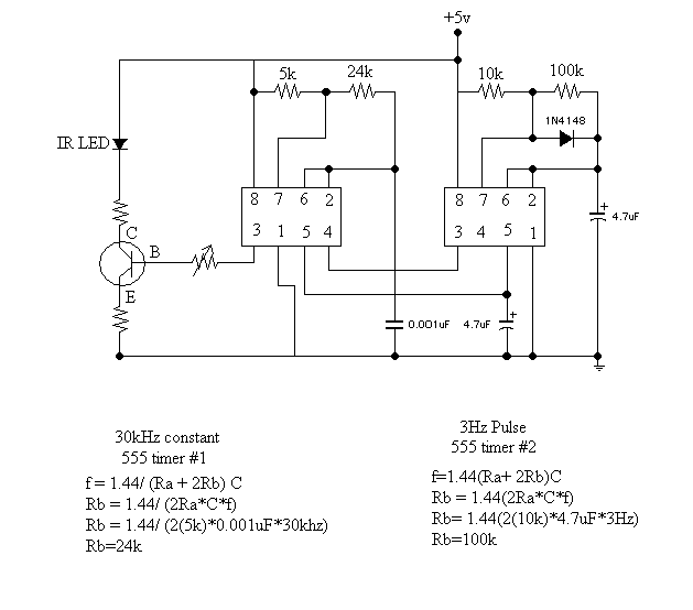

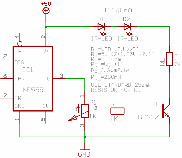

My new plan is to use the attached schematics. The first schematic ("IR Transmitter.GIF") is the 555 timers, and the second schematic ("IR-TX.gif") is the IR LED, without the 555 timer shown in that schematic. I'm connecting the 2 to create the 30 kHz pulses at 3 Hz bursts, and then have a variable gain to the IR LED. I found these schematics on another thread.

Well Thanks for all your help and the help from others. I really appreciate it. I will give this circuit a try sometime soon and get back to you with an update.
Sorry for the late response, but due to finals, work, a friends funeral I have had a hard time finding time to post and test the circuit.
I have the circuit hooked up as I type and seem to be unable to receive anything. I checked the connections and found nothing wrong with the way the schematic shows the connections. When I used one 555 timer to generate a 30khz signal I would receive signal, but not all the time and only about 3 ft away.
Ok. I found one problem. I had pin 3 grounded on the pulse 555 timer feeding the transistor. Now I measured the current going into the transistor to be 1mA. The current out is around 5mA, not enough drive IR.
The voltage across the IR LED is 1.2Volts each, since I have 2 in series there is 1.2 V across each making 2.4 across both IR LED's.
What is causing my current to be so low?
You shorted the output of the 555 which damaged it.
Replace the 555.
With a base current of 1mA then the collector current of the transistor should be at least 20mA.
Maybe you have the transistor connected upside down. Check which pin is which on its datasheet.
