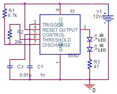

please send me the working for the circuit given by you that is IR transmitter circuit.....plzzzzz ineed the working for that ckt please help me..i found my circuit in this page attached to one of the thumbnails .plzz any one help
What is a "working"? Do you mean a "detailed circuit description"?
The IR transmitters in this thread are just 555 oscillators. There are many tutorials on the web about the 555 oscillator.
yeah i need the datailed information about working of the ckt.....that ckt is in this page only ..1st page in thumb nail.....i'm not able to attach that ckt...to this message
The first thumbnail on the first page of this thread is an IR transmitter that was posted by me. It is an ordinary 555 oscillator driving two IR LEDs in series. The LED current is (12V - 2V - 2.6V)/47= 157mA.
Look at a tutorial on the web that describes how an ordinary 555 oscillator works.

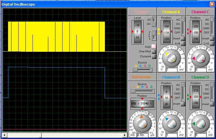

you might want to try this circuit. It was designed for obstruction detection between posts of a sliding gate. (to prevent closing the gate on a car)
The number of IR-LEDs is not the most important thing concerning range.
Most IR-LEDs have an IPCE value of 0.5 to 15mW/sr. The LD274-3 has one of 80mW/sr. Fitted with a reflector the maximum range is about 15m. The max. forward current is 100mA.
The current limiting resistor is calculated for VCC=5V and maximum 50mA forward current.
The circuit as posted here has no additional circuitry for a steady low or high output. If you use an MCU you can easily calculate for two or three full cycles (of the burst control oscillator) to determine if the signal is actually high or low.
It will be steady high when the IR-beam is broken.
The oscilloscope screenshot shows the signals at 13Hz burst control frequency and 20% duty cycle.
Remark: You might connect the /Reset pin (IC2) to VCC or leave it floating. I omitted it for PCB layout considerations.
Boncuk
