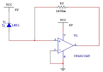

If I connect a transimpedance amplifier to the photodiode, this will convert current to voltage and amplify it, right?
Confused on this now!!
Do we want to convert the "leakage current = photocurrent" of the photodiode or the current being drawn from the power supply by Rf or both.
In other words, which current do we want to convert to voltage? the photocurrent or the current coming from the +5V power supply which is being drawn by Rf? or both?

Hi QuickStrike,
The following webpage tells about the limitation and pitfalls in working with photodiode and photoamplifiers. Worth a look at the presentation pdf.

Hi Quickstrike,
If you don't turn around the photodiode and add a voltage divider with two resistors at pin 4 like pin 5 has, then the circuit won't work.
Then C1 would make a highpass filter (passes high frequencies and attenuates low frequencies) with the series combination of the source resistance of the photodiode in parallel with R2, and the parallel resistance of the two new voltage divider resistors. Then the response would be down 3dB at the cutoff frequency using your correct formula.
