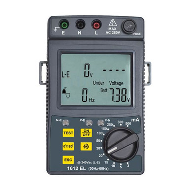

Just buy a commercial ELCB tester...
eg.
