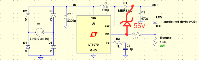

I added a 1k resistor in the feedback path. It will have no effect.

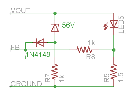

I added a high voltage Zener diode from "OUT" to "FB". If there is no load (diode was not in circuit) then a small amount of current will flow in FB and cause the LT1070 to limit the voltage to about 57 volts. The value of the diode is no important. It needs to be more than the 38 volts of the diode and less than the maximum voltage of the IC and D1 and C1.
We tried above schematic voltage in no load condition is solved but output current is too low. The Report of above schematic is

This gives me the idea the Zener has 500uA of current. Change the 1k to 100 or find a zener with less current. You need a resistor there!

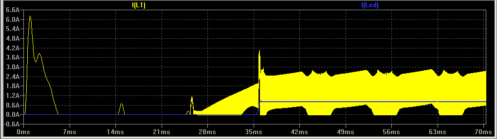

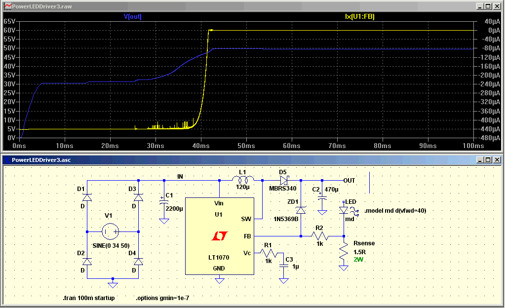

Simulation shows the schematic with Ronsimpson's helpful mod (post #21) should produce an output current of 0.83A.

You can change the 1k to 220 or 100. That will help the leaky zener problem.

Zener problem: I can see the zener is send too much current into the FB pin. This new circuit will send the zener current to ground through a 1K resistor. Only when the current reaches 1.5mA then the zener will pull up on FB and shut down the IC.

I don't think the feedback pin current is a problem, Ron. Simulation shows that it actually goes close to zero when the zener begins to conduct if the LED is disconnected.

When the LED is passing 0.83A the peak current in the inductor is approaching 3A, so the inductor must be rated to handle at least 3A without saturating.

From #22 & #23, when the Zener is in place, with a good LED, the current is 1/3. That tells me that his Zener pass 500uA to 700uA. The high voltage Zeners pass some current below their turn on voltage. The circuit in #30 will probably solve this problem. We are looking for a zener that will not effect FB at 40V but will turn on just below 60V. (FB current is very small, the problem is zener current at 37V)
