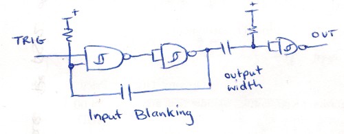

You can also use schmitt-trigger gates to get whatever function you're after. The one shown is for the nonretriggerable monostable.

The time that it won't trigger for after the initial trigger edge is set by the initial input blanking time (the leftmost RC). The blanking time will always be >= the output pulse width. If you wanted the blanking time to extend a certain time after the last trigger, then simply placing a diode between the first NAND inputs (pointing towards the trigger input) will accomplish that.
