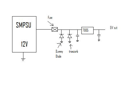

Building a small uC board which is going to be used in a noisy industrial environment. I want to try and give my circuit some protection from possible spikes / emc interference. The board uses a 7805 regulator with decoupling caps and takes its power from a 12V switch mode power supply.
I was thinking of using a fuse and dummy diode and maybe a tranzorb on the input stage.
Do you think its necessary to add any additional filtering to the board. I assume most switch mode power supplies are reasonably clean and most of them seem to have good protection/safety features themselves
If anyone can provide some tips or experiences they have had with circuit protection i would love to hear from you.
thanks
What's a "dummy diode"?
Crutschow - a diode to prevent incorrect polairty. Forgive me if you are joking.
blueroom - the board does a mix of both. Measures temperature, controls pwm fans, switches relays, rs232 comms etc.
I just thought the power section could do with some input protection. Like i say, the SMPSU is an off the shelf type, has protection of its own, but its not to say a fault wont pass through to other devices its powering.

The diode is fine, transorb probably not necessary. How much current does your circuit draw? At 12V those 7805's will need a heatsink even for light loads.
Do you know what a crowbar circuit is? For this, a 13 or 15 volt zener to the gate of an SCR, put this where the tranzorb is so it will blow the fuse if the smps goes high.
yes i was also wondering if the tranzorb was necessary. I have not included a heatsink as of yet, i was hoping to avoid if possible to reduce the profile of the board. Ive gone for a smt type 7805 (DPAK) and made the rear face pad (GND) as large as possible. I have not done any current measurements yet but i would say 0.5A max.

As Bill noted, you would need a heatsink or go with switchmode supply for that load current. The 7805 power would be (12-5)V x 0.5A = 3.5W with a 0.5A load, which is more than the PC board alone can likely dissipate.

The most you could expect out of the DPAK is about a watt. If you check the data sheet the junction rise over ambient is 95C per watt with a maximum junction temperature of 125C. So with your 7 volt drop across the regulator you could only expect .14 amps. The PC board will help but it is not the best heat sink (one side is insulated and the copper is to thin to dissipate the heat well). About all you can expect from the board is about 50C per watt. The better choice, if you stick with the linear regulator, might be the TO 220 and a small heat sink. You need to get rid of 3.5 watts (7v x .5a). You can get a rough estimate of the heat sink size using Trise=50/sq rt of the area in cm. A little aluminum U shaped heat sink with a couple of square inches would do it.
i would replace diode and transorb by a unidirectional TVS ike this one (same as zener but a lot more fast and can take high current transient), it can absord very high surge and it is also act as a regular diode

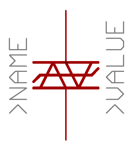

Here's a good way to protect circuits from spikes.
It's a TRANSIL diode manufactured by ST. It's available uni- and bidirectional for a great range of voltages.
I use it for protection in automotive applications and it has never failed till now.
Have a look at the data sheet.
The correct schematic symbol (DIN) is also attached.
