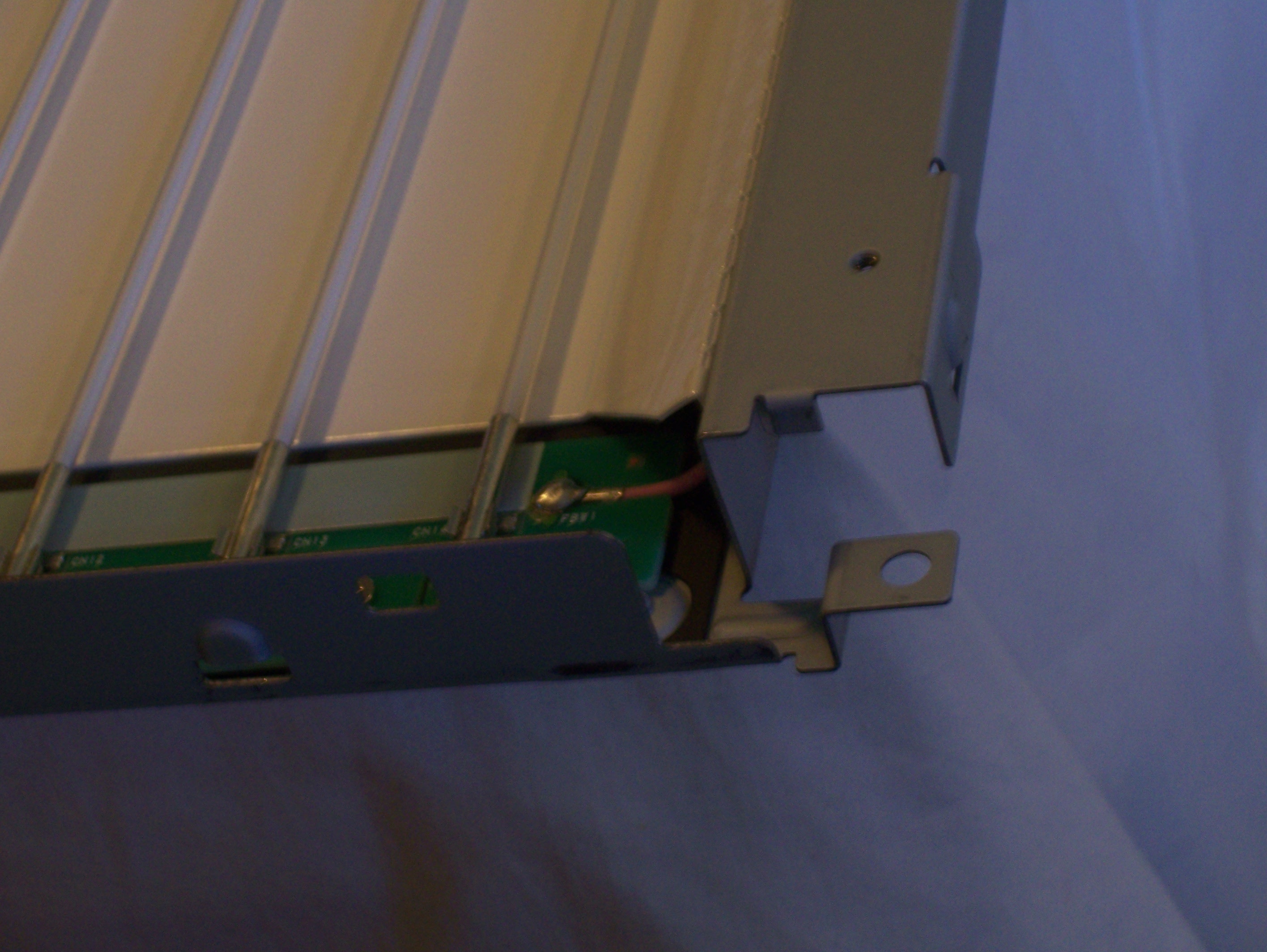

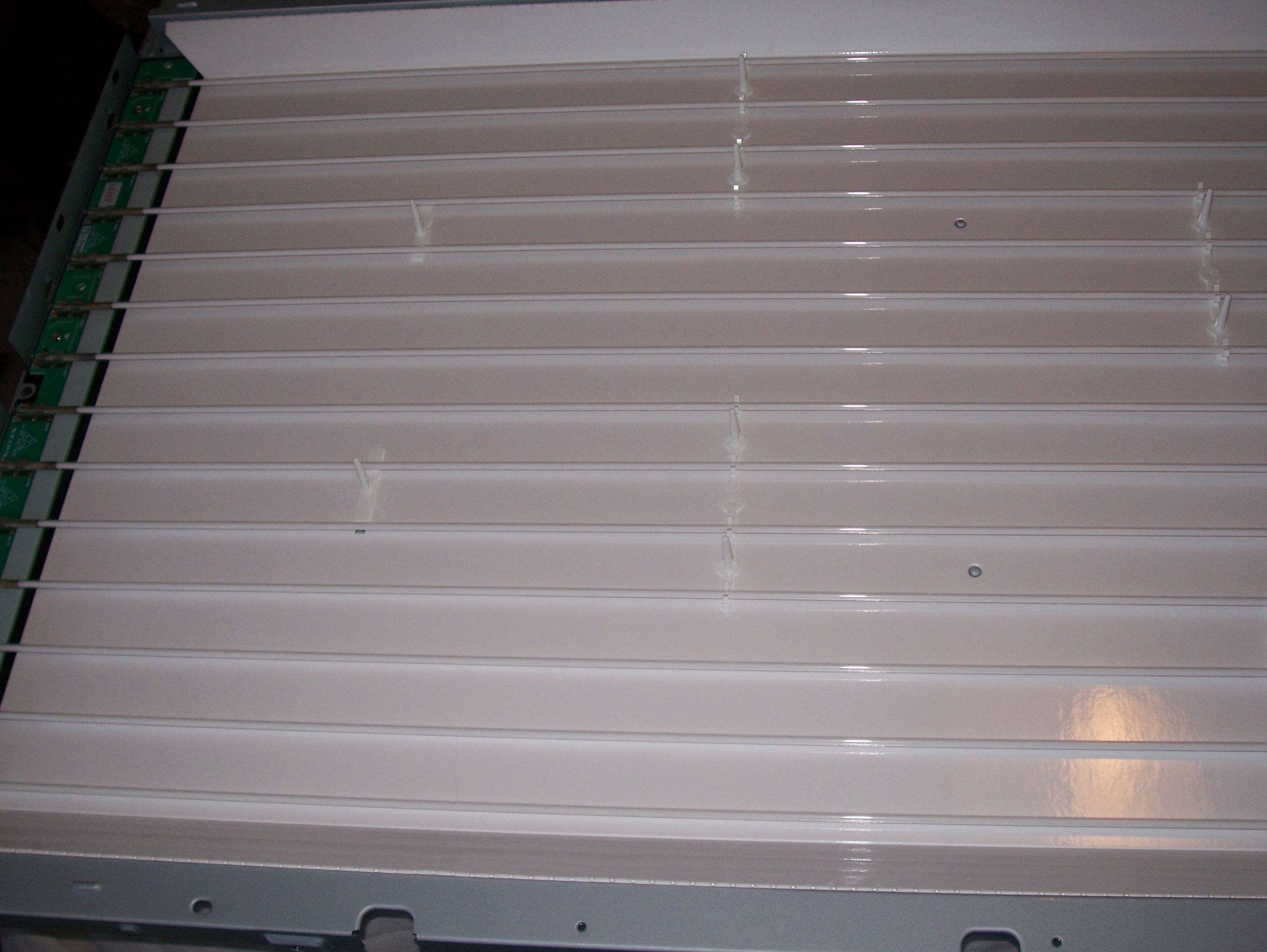

also, I just dissassembled the tube housing and found what looks like a cold solder joint on one of the lines that supplies the High voltage. I'm hoping that's it.
Also, among the tubes, there is one that is slightly darker than the rest. Could this be a dead tube? if so, could I possibly replace it with a very thick wire to test the rest of them and see if it is the problem with the unit? (it is the lowest one in the first pic and the furthest right one in the second pic)

what u need to do is disconnect the invertor from the power supply,then switch the set on and check to see if yr 24v rail for the invertor is present,check the standby 12v,and 5v rails,there may also be a 3.3v rail too used by the micro on the signal panel-with the set in standby with the invertor disconnected there should also be some supplies that are always present-5v supply being one of them.
if you get no voltages from the secondary of yr power supply it could mean you have a simple powersupply fault on the primary side of the supply stopping it from starting-low esr electrolytics,start up resistors high in value or oc-depending on model there are many powersupply kits available which will cure most psu problems.the other thing to check is the power on signal from the signal panel-may be active hi or lo depending on model if this is missing the supply wont come on.
the fact the invertor initially worked ruled out a fault with the lcd backlight assy-you shouldnt have dissassembled it as they are made in clean room conditions and any dust ,dirty fingerprints etc will be visible on switch on when the lcd is working.
another item on the invertor board to check is each individual transformer,you only need one to fail which will shut the set down. be very careful with taking measurements in this set and if using a scope you need an isolation transformer to power the set or you will cause more problems -if you need a service manual then let me know and i can supply one for it

where i work we see a lot of TV's including insignias. the most common problem with them is bad caps in the power supply. the second most common problem is bad inverter boards (the ones that feed the FL tubes). the inverter boards have a sense circuit that will tell the main cpu that the inverter isn't working. you might try removing the dark FL tube and see if it then lights up. i've found that an ESR meter pays for itself very quickly. if you have a function generator you can make an ESR tester jig. feed the function generator (100khz sine wave10V p-p) through a known resistor to a set of test probes. read the voltage across the probes with an oscope or a true RMS DMM. with a cap connected across the probes, the voltage is proportional to the capacitive reactance (which at 100khz should be pretty low)at 100Khz plus the ESR.
