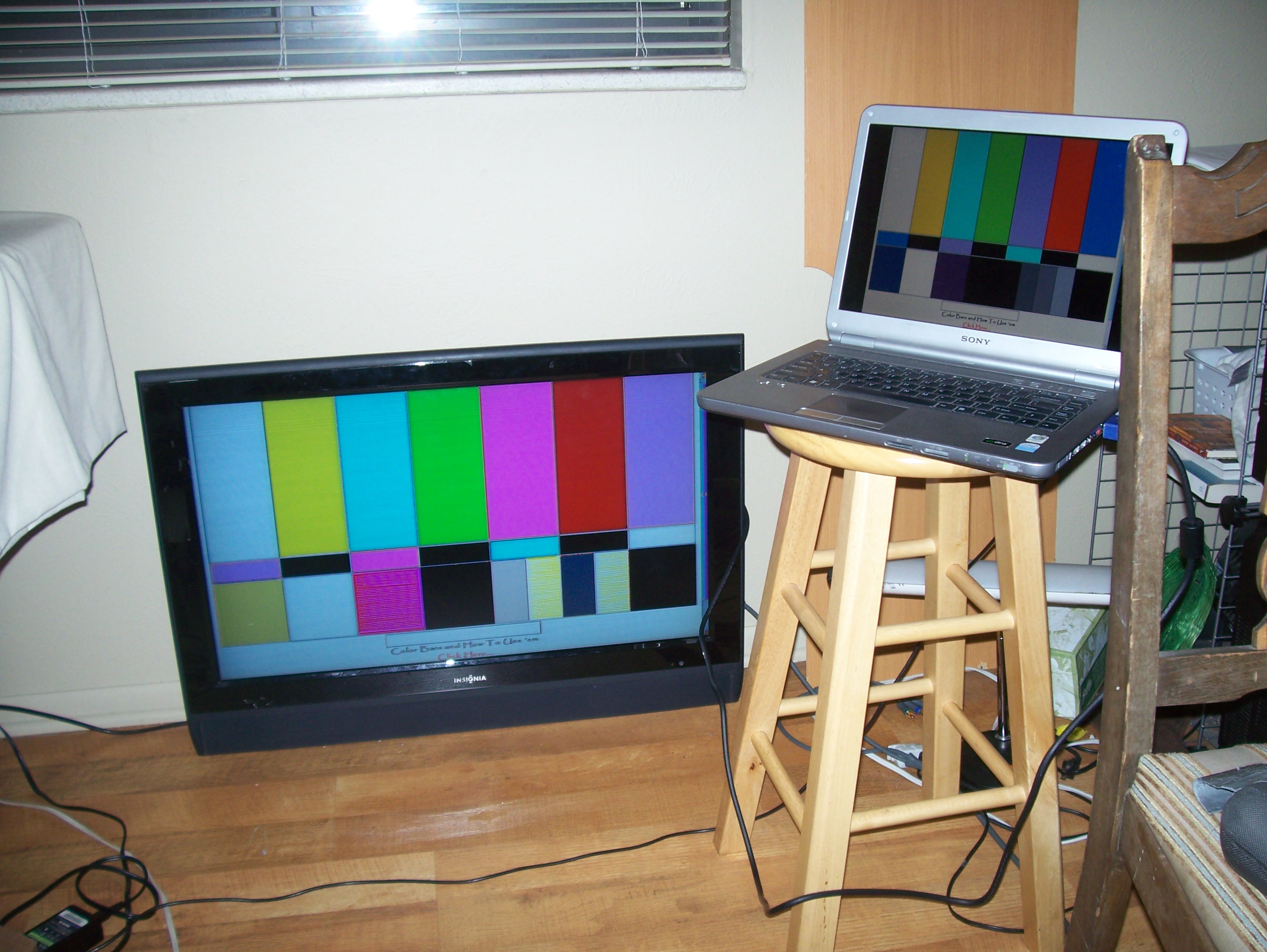

As promised, attached is that photo I was talking about, hopefully describing the new problem I am trying to diagnose.
Through some of my research, I have not found a leaked service manual yet, however I have found a code that will access a hidden menu. Using the remote, entering the 4 digit sequence:
2 5 8 0
in any setting but TV will access a menu with a list of options including AutoColor, White Balance, and Service Menu. Tried a few of these with no success, and when selecting "Service Menu" I believe either another code/some form of equipment may be required as the selection simply makes the hidden menu dissapear

Well, this past weekend I came across a tad bit of success in my search. Googling that code mentioned above with NS-LCD gave me a promising link:
https://www.electro-tech-online.com/custompdfs/2012/02/LCD20TV20NS-LCD37_SM.pdf
This link is the service manual for the NS-LCD37, but aside from some programmable output settings, it's practically the same main board as from this NS-LCD32 set.
Now, to be honest, it really didn't help me out a whole lot (atleast at this point in this project), but rather gave me an idea to try. In the manual, it describes calibrating the set using a few particular signals from a video signal generator/calibrator .
So, I thought maybe if I try to "create" my own signal generator using the Ladder 16 grayscale described, and the VGA out of my computer, I could try to get something "close". This proved to be just that though: close. The attached image is the set running with the described image sent to it. Running through the auto color configuration did clean up the output a tad, but I can't get it to be exact, hence the result of my poor man's video signal generator.
I'll call a few local repair shops, describe to them exactly the routine I need completed, and pray something I can afford can be negotiated. We'll see though. Ah, if only proper equipment was accessible......

Might just seem like words of encouragement, but when I was younger (maybe 13/14) I was surprised at how helpful the folks at repair shops were. They would often let me do the work using their equipment, and giving my pointers here and there - as long as I did the work because they were too busy. Probably realised they couldn't make any money form me, but I learned a hell of a lot from a few hours in a TV repair shop. I'm sure they'll give out some free advice to narrow it down, and might even let you borrow some test equipment.
