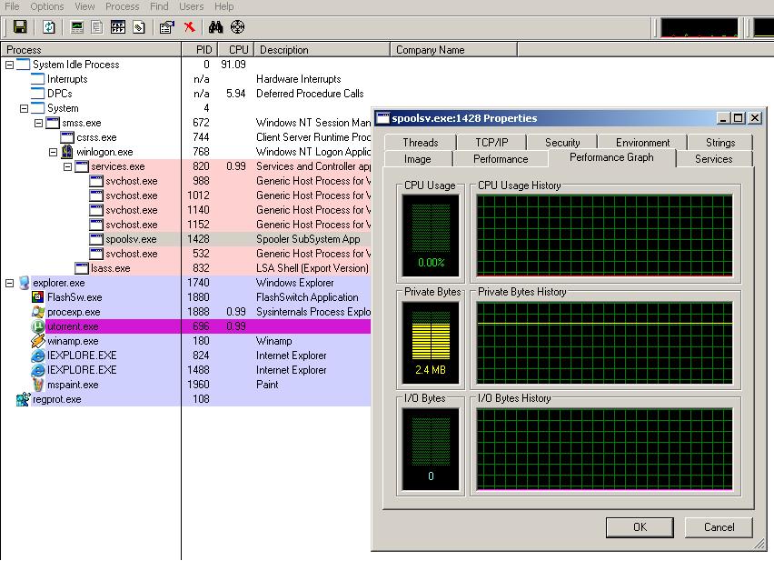

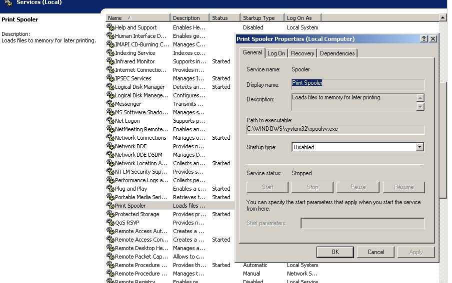

Lol, That's just not cricket old chap, the first thing i do after installing win2k or XP is go into services and disable useless programs that microsoft has decided i need, ie Messenger, remote registry, remote install and helpsv. I have been doing this for years and it has not messed anything up.
Because i'm running process explorer i have a good idea of what rubbish is running in the background and at startup and Regprot is a simple program that lets you know when something is being added to the registry for startup. Using these little freeware apps keeps the machine cleaner than it normally would be without them and I would not suggest anything that i didn't think was the mutts nuts.
Did you know that you can already do that with native XP components at the command prompt?
XP, NT and Win2k can all view processes and kill some of them, 90% of the time though windows will not let you kill them. Process explorer is just an advanced version that lets you have a lot more information and control over whats going on, try it and see. In this pic i just noticed i'm running a print spooler when i don't have a printer on this machine, 2.4MB of RAM wasted, it's a laptop with only 256MB so then i ran services.msc and stopped and disabled it. Sure i could have done it without processXP but hey whatever floats ya boat.

cricket or no cricket, I was ballancing out the bad advice (ie no warnings) that is given from Quack-viper. His orignal site is well known and he promised soo much from doing soo little with no warning of the concequences
FACT
serivces once started IF not used (ie the remote reg) get swapped out by the NT-kernel very quickly thus no RAM/CO=PU is used by them
this is true abt most of the services.
