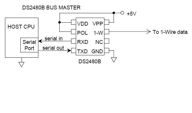

Agreed. Since I have the probe, I think I'll be using this schematic which is almost the same as the one in the link you gave me. Should be good right?

That's a good general idea. Now you only have to fine tune the schematic (add some capacitors and a way how to power the circuit) write the software and you are ready to go.
Thanks for your comments. As blueroomelectronics suggested, I would construct the circuit shown on the datasheet. However, I've been reading up on the literature on how to read/write a 1-wire device through serial ports and I've come across the name UART many times. I'm a little confused as that piece of literature emphasizes on the use of a UART chip but the data sheet schematics show no sign of a UART chip in there.
What are your opinions?
For reference here's the link to it
https://www.electro-tech-online.com/custompdfs/2008/05/AN74.pdf
UART is a part of MCU or PC, it is not essential but it simplifies writting the Software. It's a hardware unit that takes care of low level serial operations.
