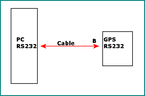

I don't know why the LED would not go off. Do you know how many wires are there on the GPS RS232 port as the connecting cable plug might have internal handshaking connections.
On the cable that works with the PC, use an ohmmeter to check the cable plug pins that goes into the GPS RS232 port. i.e. item B in the image below. Assuming a 9-pin port.
Is pin 7,8 connected together (RTS-CTS)
Is pin 6,4 connected together (DSR-DTR)

well EBLC, really it's so kind of you to concern about me , thanks a lot, you are really a gentleman :)
i've tested the cable pin ass. , and here is the result
the pin 1 goes to pin 1 only
the pin 2 goes to pin 2 only
the pin 3 goes to pin 3 only
the pin 4 goes to pin 4 only
the pin 5 goes to pin 5 only
the pin 6 goes to pin 6 only
the pin 7 goes to pin 7 only
the pin 8 goes to pin 8 only
ha? :roll:
