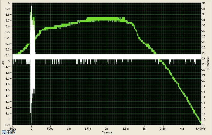

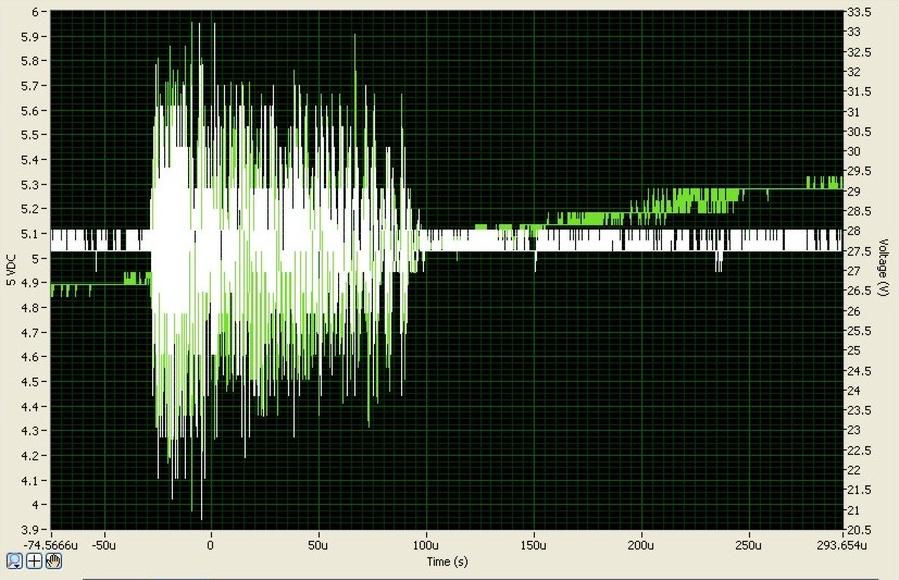

Hello,
I'm attaching these snapshots of the interference problem, the white signal is 5VDC and the green one is 24VAC, one is without zoom, and the other with zomm. This happen in 125 uS....
The permanent oscillation in the 5VDC signal ( 5.03 to 5.12 ) is normal for a PC power supply ??

The transients you are trying to eliminate are above 37 volts. The smaller spikes between 24-37 should not be causing your problem.
Without the TVS devices the solenoids and motors will generate transients which can be 100s of volts. These large spikes will be causing your problems.
While I receive and install the TVS's, could you help me with this :
The permanent oscillation in the 5VDC signal ( 5.03 to 5.12 ) is normal for a PC power supply ?? ( please see the graph attached above ). These oscilations are happen at a very high frecuency.
Or I need see a perfect line without or less oscilations, to know that I have a correct power supply ?
The noise you describe is the switching noise from the regulator and should not cause any problems. Do you have filter capacitors on your control board?
