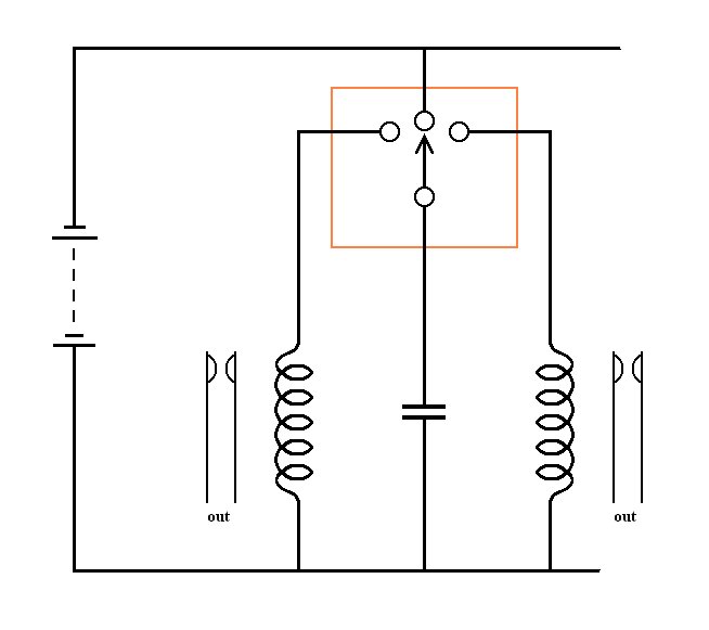

I am putting forward this skeleton diagram, not as an answer but as a possibility.
As can be seen, there is no resistor in series with the cap,
thats ok on a small dry cell battery run unit, the cap wouldn't be large anyway.
It wouldn't be ok on a larger re-chargeable battery unit,
which is why i asked if the intended relay and switch box was meant to use the
same battery or one of its own.
Mikebits,
previously i mentioned using an arrangement where a cap or caps would charge,
then would only use leakage current.
Rather than using a cap to close a relay using its charging current.
Although the difference to the relay may be insignificant, it requires an extra
resistor, which unfortunately has to remain in circuit.
Using a cap or caps from a charged condition means that (for this) the discharge
into the relay coil determines how long the relay operates. The cap would be
chosen to give the period required.
Just as you have already shown in your diagram, but round the other way.
You have put 1 Mfd caps, i would have guessed at around five or six.
The advantage to doing it like this would be to minimise battery current.
(also i am fiddling about, trying to see if the posts will support an image,
i dont think they will, but i'll have a go)
Regards, John :)

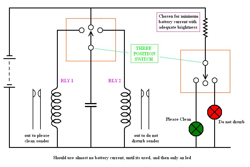

Hi Adrian,
I've posted another picture.
Same arrangement, just filled in a few bits.
This should use no battery current, except capacitor leakage, which is almost
shelf-life for most batteries.
Until its used, then its just LED current until its switched off again,
then a little to recharge.
I think its battery should cover a month, or more.

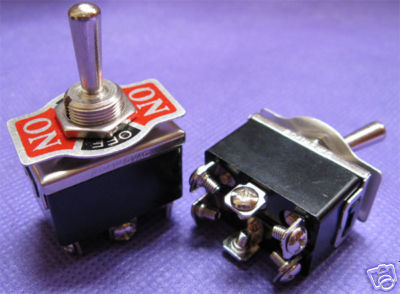

Just noticed a problem with my submission.
I dont think the toggle type switches have a connection in the middle position.
So, unless anyone knows of a type that do have a connection in the middle,
then that arrangement i posted wont work.
Or the OP could consider a rotary type.
Meanwhile i will have a little think, in case theres a way to do it without a
connection on the middle position.
( yes i know i can remove the posts, but i just dont care. )

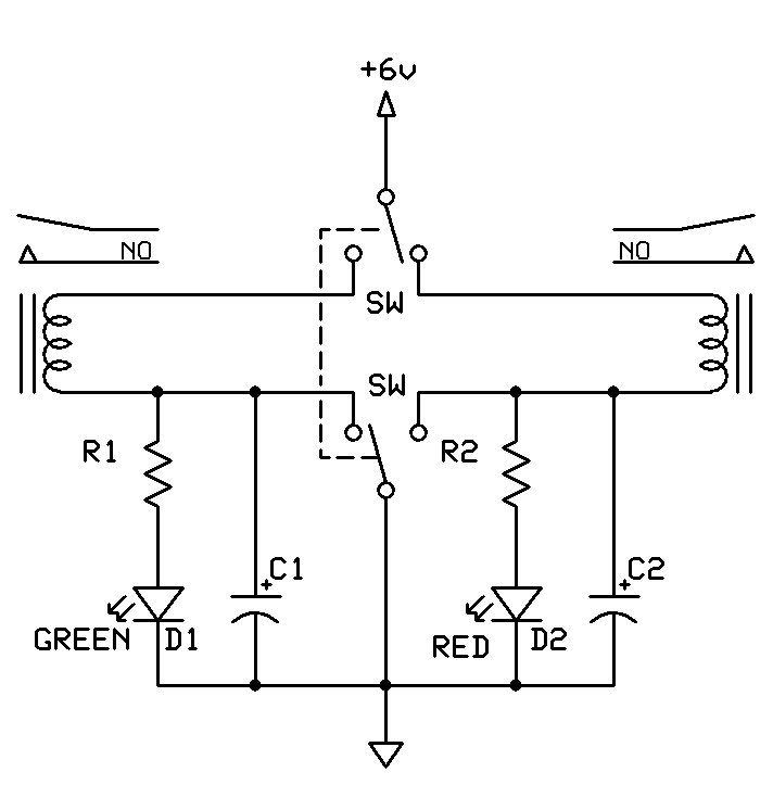

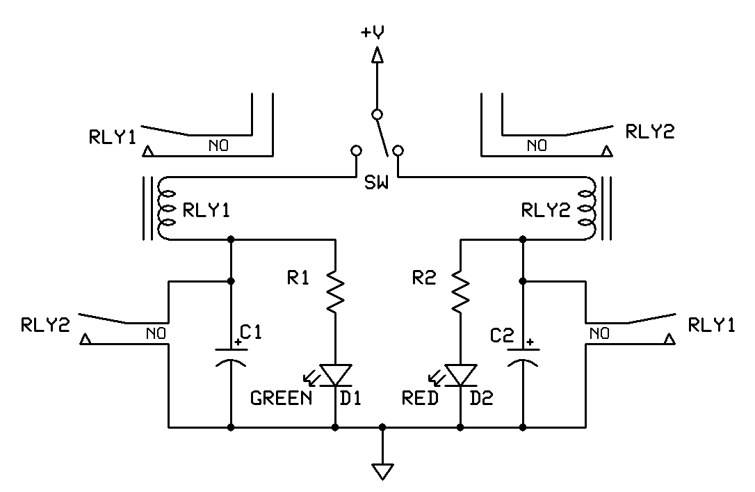

I still think a µcontroller, with Mosfet's switching his "remote control " is the best "low power" solution. But since I was playing with relay switching in another thread I came up with this "all in my head" circuit...no bench testing...therefore no component values. :) The second set of contacts on the relay quickly discharge the opposite relay's capacitor, more rapidly extinguishing its LED at switch-over. Led current and capacitor leakage are the continuous load on the battery.
Ken
Thought I should add my first concept too....the second image. :)
I think your right, but the OP may not have any experience with such things as writing code. Then again, I could be wrong as that happens a lot :)
Hi Ken,
Thanks for adding your relay based idea possibilities.
If the OP has only limited electronic experience, very often relays are a practical solution.
working with integrated circuits is all very well, but relays can often be much simpler.
Ken, i have looked at your circuits closely, and they are (of course) correct in their
operation.
They use standard type relays with c/o type contacts.
I was thinking of reed-relays because of their low power requirements,
however, the relays would only be operated a brief period, so maybe standard types are Ok.
Plus with standard types, one can see the operation of the unit, which can be important to
the person making the unit.
I rather like the added contacts on each opposite capacitor, because:
Without them, if the user goes from one position to the other, a couple of times before
leaving it in the position he intends to leave it, then the cap could retain enough charge
during switching to malfuntion.
However the inclusion of these extra contacts ensures that the cap is discharged each time
the switch goes to a choice.
This was something which had me going, namely repeated or accidental switching by the user,
which with one of my earlier circuits would be a problem, so i did not include it.
I dont see from your post which of the circuits is the one you recommend, i assume its the
one with the extra contacts.
I can see no improvement to this circuit, other that simply using a single resistor for
the LEDs, which is hardly worth mentioning.
In fact, i think you have nailed it with that circuit.
Regards, John :)

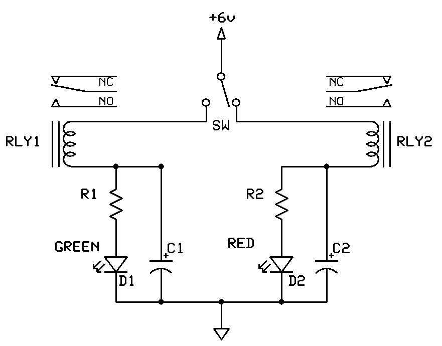

John1,
Another iteration. :)
In order to use the smallest capacitors possible for the delay, you need relays with the hightest coil resistance for the given battery voltage. This implies miniture relays. This also means relays with low contact current ratings. Using small relay contacts to short out the capacitors would probably shorten their life. So, I just replaced the second set of relay contacts with a second set of contacts on the toggle switch. Might be even cheaper.
Ken
Because red and green LEDs have different light outputs and voltage drops for a given current, I chose two resistors to allow for optimization for lowest current on each.
