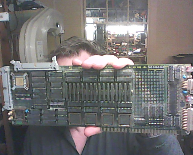

This board had a "ENGR-SAMPLE" of the DP8500 so i do have a special affinity with it. This was in 1986, when national with its DP8500 and TI with its 34010 were the first 2 companies to offer processor based graphic engines opposed to the mainstream still using graphic controllers like the then famous NEC7220.

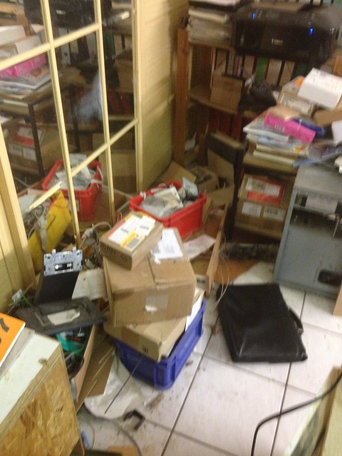

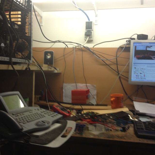

Over many years i did start to work on building myself a workshop and get order into the many things I did have in inventory. Luck of enough financial resources I had to switch from buying a part I knew I already had to get order into the stuff that had accumulated over decades.

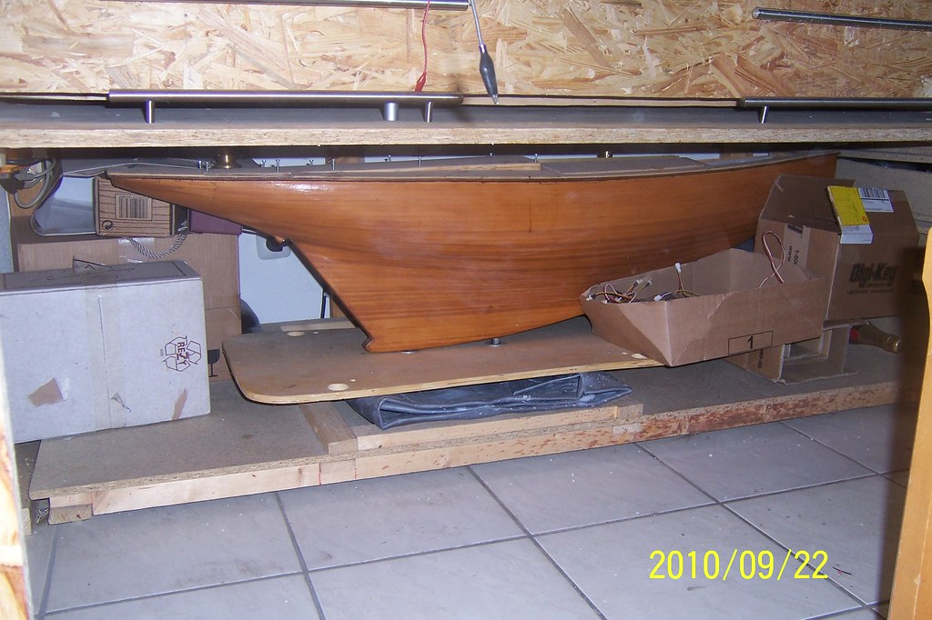

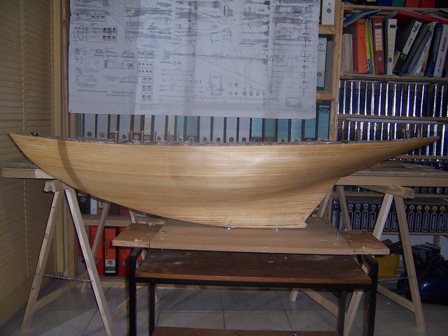

Here a few photos to entertain you and to make the reading of this thread easier. Here a view of the body of my sailboat. Working with wood is a very sensual work as wood feels nice and moving your hands over the surface of the body shown here is pleasant.
As one of the purposes in working on this model was learning about the technologies I was encountering in this process, first wood as shown in the previous image, then plastics while working with fiberglass and epoxy to working with aluminium which I did use to build a deck completely detachable from the wooden body of the sailboat and brass. I will not go into the countless issues that fascinated me as this is outside the scope of the community.

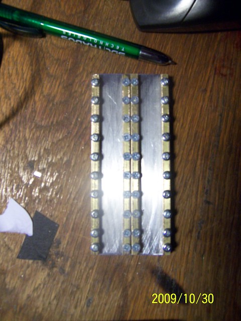

As I will be using a great number of this LEDs in my model i had to build a device which would enable me to build identical boards and to be able to build more of such boards in the future. The requirement to place the holes at their exact defined locations prove to overstress the equipment I used until then. So I decided to my a mill shown on this picture:

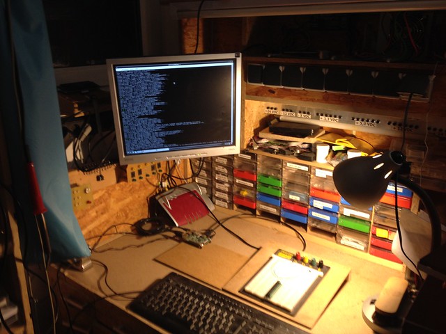

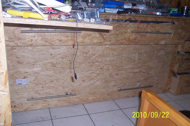

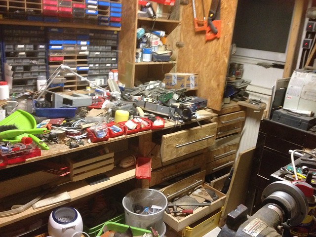

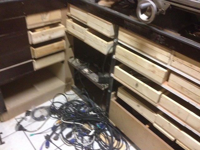

Now I decided to update my workbench to be able to take a huge number of sortiment boxes so that I could start to place the endless number of devices I had laying around!

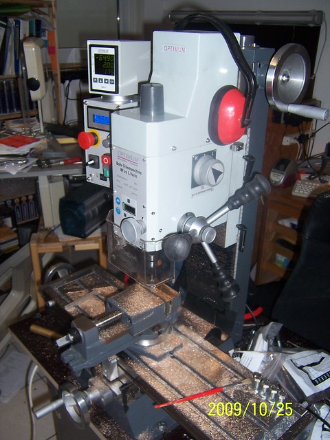

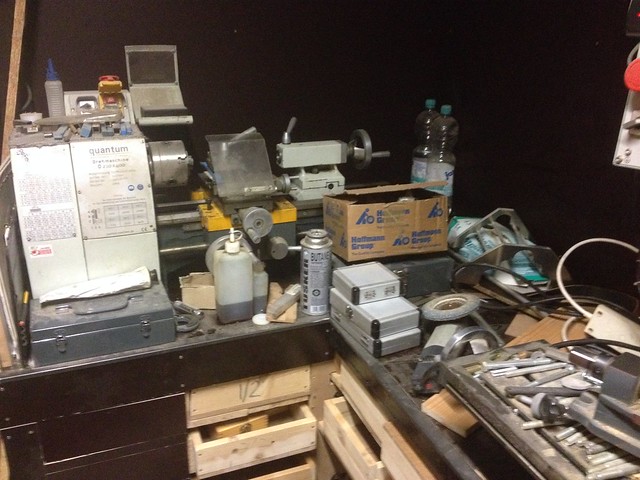

So the next mayor piece of equipment I did purchase was a lathe:

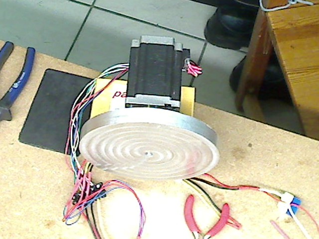

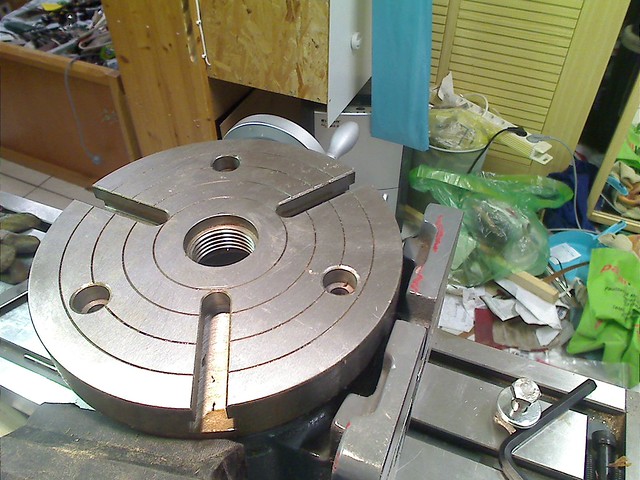

Here a picture of the sheet drum I plan to use. Together with the stepper motor and the control circuitry it makes up the winch. I had to stop my work on the drum as my milling machine got damaged. I did use a rotating table mounted on the coordinate table of my mill to mill this raw version of one of the 2 drums I will have in my sailboat! here a picture of the rotating table mounted on the coordinate table of my mill:
The next picture shows the side of the drum that will be connected to the stepper motor!

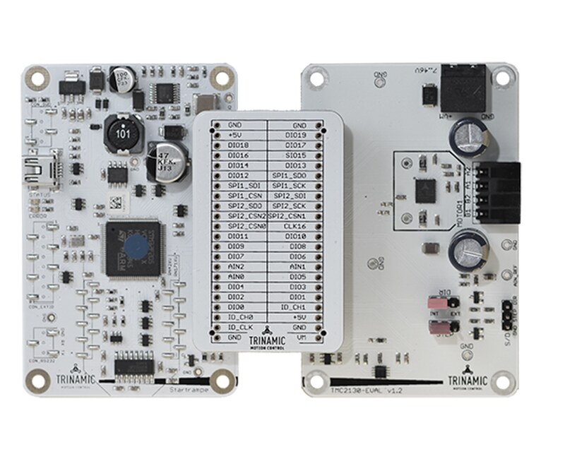

Next the picture of the next generation stepper motor evaluation kit from Trinamic:
Great about this evaluation kit is that it allows to look into the operation of its TMC2130 stepper motor controller. The right board contains exclusively the TMC2130 and it can be operated with supply voltages up to 60 VDC! The left board is the containing an ARM Cortex controler with the firmware that allows to control the kit via the Trinamic IDE downloadable for free from Trinamic and the source code of the firmware is available. It communicates with the controller via the ARM Cortex CMSIS API, what makes it relatively simple to migrate this software to another ARM Cortex M controller that offers all the peripherals required! The middle board makes all the signals between the two board accessible, so that i.e. they can be viewed and analyzed using logic analyzer i.e.!

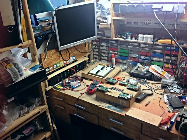

All of this made it evident that I needed further upgrading my workshop!

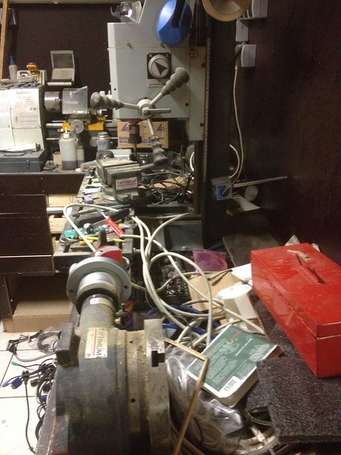

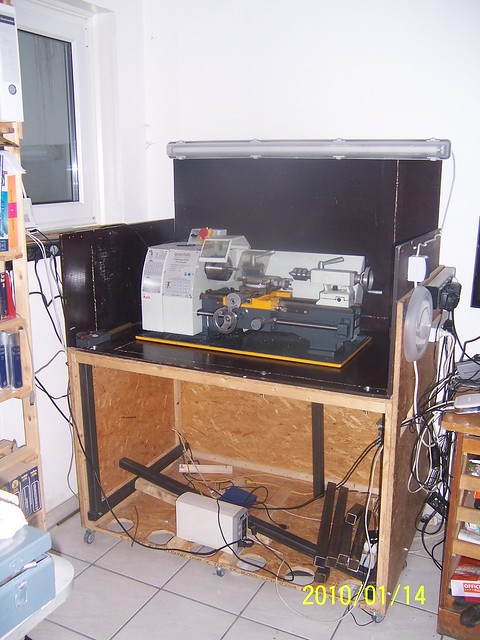

First, with the help of a good friend while I was recovering from my first stroke, we separated as much as possible the dirty work function is my workshop in one area of it and we build a second workbench!
This picture shows that area of my second workbench with the lathe!
