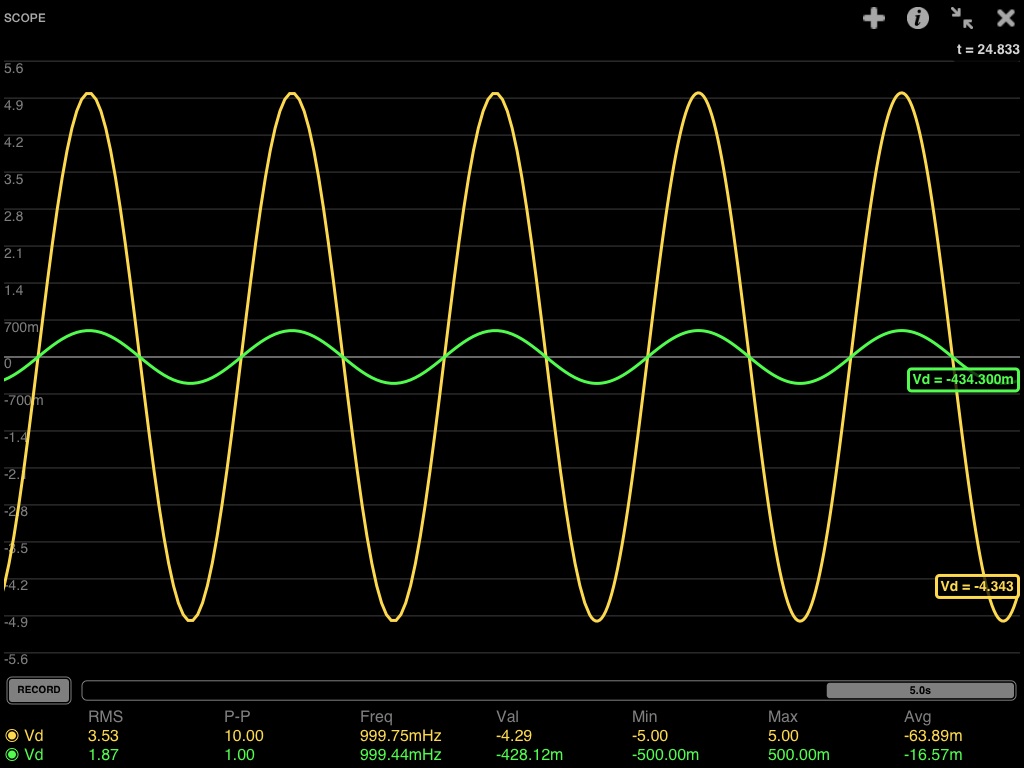

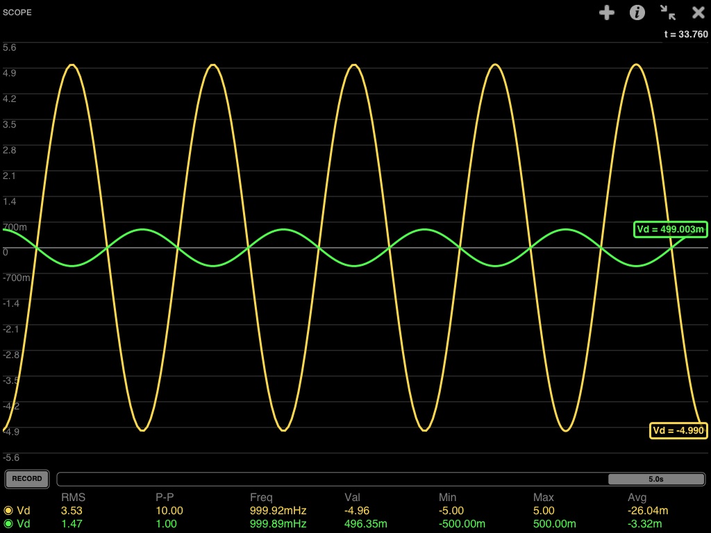

This is my report,I have also attached a rubric to give you a rough idea of what is expected.
I would really appreciate it if you could check it out.
The actual gain IS NOT -20dB which is a loss, not a gain. Instead the actual gain is 20dB and is -10 times. The dB number will not say if the signal is inverted or not. I think if you say a signal has a gain of 10 then we also do not know if it is +10 times which is non-inverting or if it is -10 times which is inverting.
Use simple arithmetic to determine the output impedance of the signal generator. If the 10k feedback resistor value is actually exactly 10k ohms and the actual gain is -9.65 then the input resistance is 10k/9.65= 1036.3 ohms. If the 1k resistor is actually exactly 1k ohms then the generator impedance is 36.3 ohms.

The gain of -10 is in the first (input signal is 1v peak-to-peak) but the sine wave goes up as output wave goes down (output peak-to-peak is 10 V).
Gain in second graph is 10, note they are in phase.
Graph 2 (gain of +10)
It might be confusing to the student to see that your scope has 7/10ths of a volt for each line instead of 1.0V.
It confuses me as well but, since it is an iPad app, the number of controls for the user (me) are very limited.
