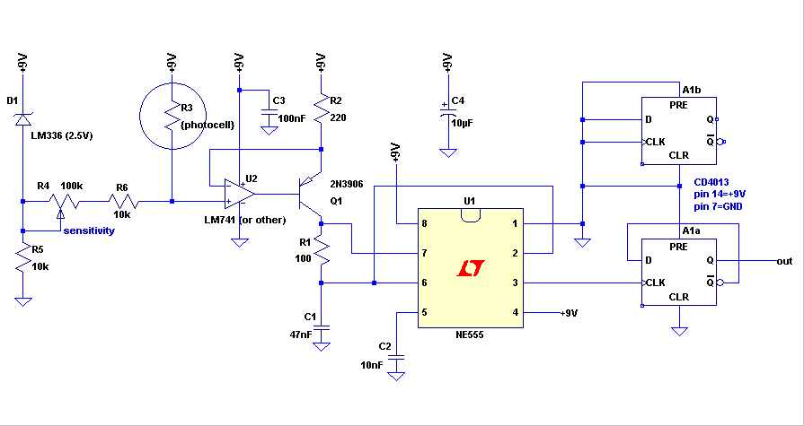

It is a remote light sensor.
It consists of a transmitter and a receiver.
The receiver is light a normal radio except that the output is shown in an LED instead of a speaker.
The transmitter transmits a tone. The frequency of that tone is based on the amount of light fallong on the CDS cell.
It seems that most oscillators carry a high pitch with lower resistance values. I want the exact opposite of this.
If you still don't understand, please tell me how I can make a long range transmitter using only BJT transistors, resistors, capacitors, and inductors, and an antenna. The transmitter must be able to produce an extremely high pitched sound in darkness (when the resistance of the cell is high) and a low pitched sound in bright light (when the resistance of the cell is low).
This is probably more complex than what you are looking for, but I think it will work. I ran some sims on it. You may have to adjust some values, depending on the light and dark resistances of your photocell. It obviously uses more than a simple 2-transistor multivibrator. I'll give some more thought to that, but my first thought was that it would be difficult to do.
If you want to transmit this by RF to a receiver, you'll have to modulate a transmitter with the output.

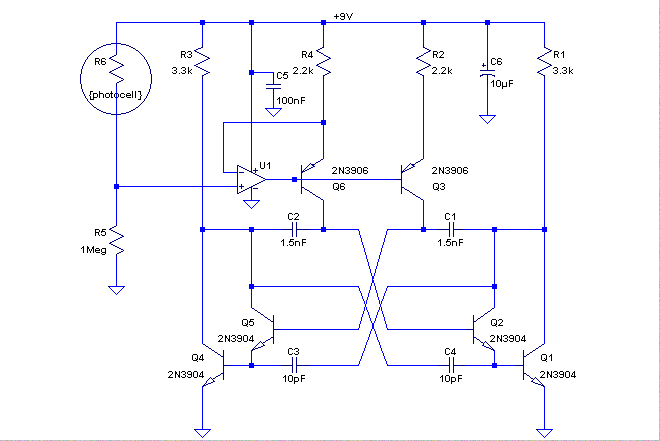

Here's a somewhat simpler version that uses the cross-coupled multivibrator. Darlingtons are needed because of the wide range of current involved, and they are also one way to solve the base-emitter breakdown problem.
Edit:
The op amp needs rail-to-rail I/O capability.
